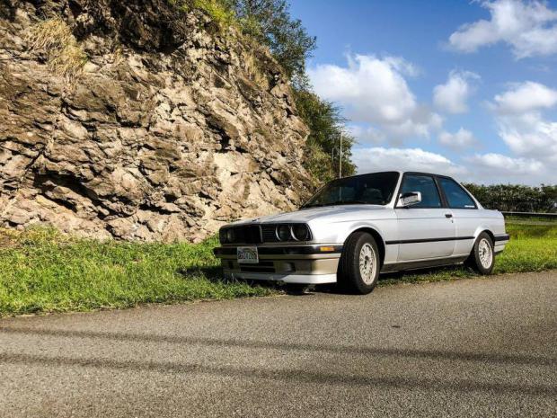

    318is Turbo Project
    I have owned a 1991 BMW 318is for about 3 years, and have used this forum and M42club extensively for learning about the car and decided I should return the favor and post the what I have done with it and where its going.
    The beginning, stock except for H&R Springs with Bilstein struts. Someone had also swapped out the headlights and swapped the clutch driven fan for a volvo electric fan wired into the AUX fan circuit.

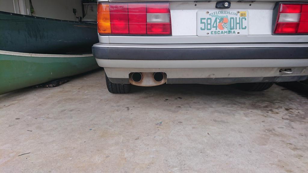

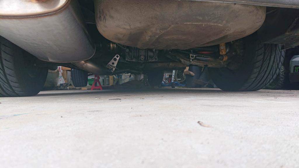

        Finally got the exhaust fabricated and put on, 3 inch all the way back with a small resonator and a Magnaflow straight through muffler in the back. Don't have a great photo of the whole exhaust but I am really happy with how it sounds. Not super loud but you can hear the turbo spooling through it. Click image for larger version
Name:	BMW (2 of 3).jpg
ID:	10026217 Click image for larger version
Name:	BMW (1 of 3).jpg
        Still need to find some tips I like to add to it and clean up the bumper a bit.

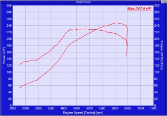

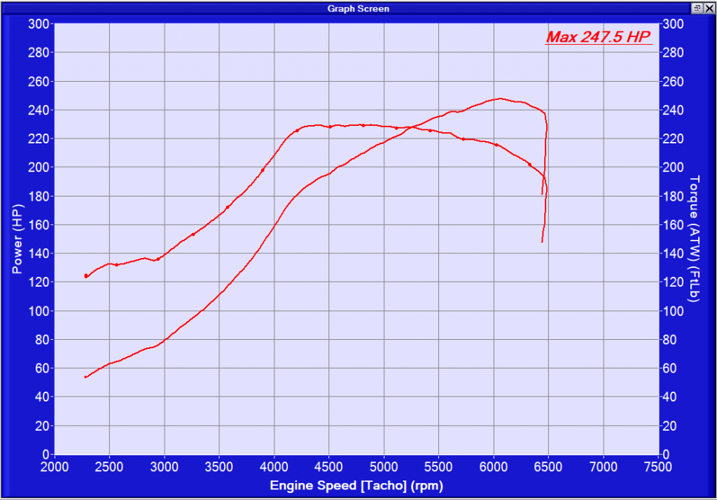

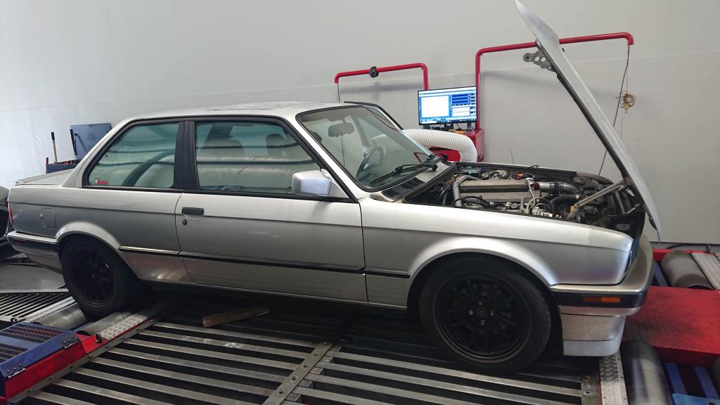

        And now for the fun part, got all the gremlins worked out and sent it off to a local tuner. Stayed a bit conservative on ignition timing and fuel since its still a high compression motor and doesn't have knock detection. Max power run ended up being at 14 psi, see below graph for the numbers. I am super happy with where its at.
Name:	BMW (3 of 3).jpg
ID:	10026218 Click image for larger version
        Bumped it down to 12ish PSI for now with about 230 HP and 215 FtLbs of Torque at the wheels, which with a estimated curb weight of about 2650 lbs makes for a very spirited machine. Huge change from what ever was left of the 137 HP from the factory. Now to get back to Autocrossing and Track days!

                          Also put some tips on the exhaust, had to trim the bumper a hair which I still need to clean up. Pretty happy with the look and the sound of the exhaust overall.
                          Click image for larger version  Name:	bmw (1 of 1).jpg Views:	0 Size:	67.0 KB ID:	10028803
