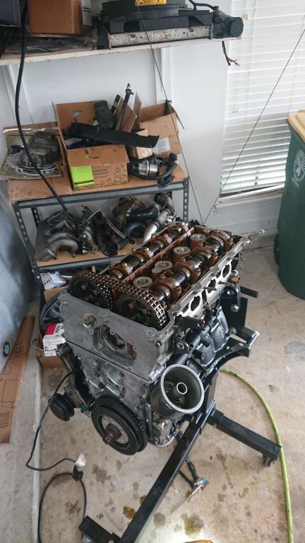

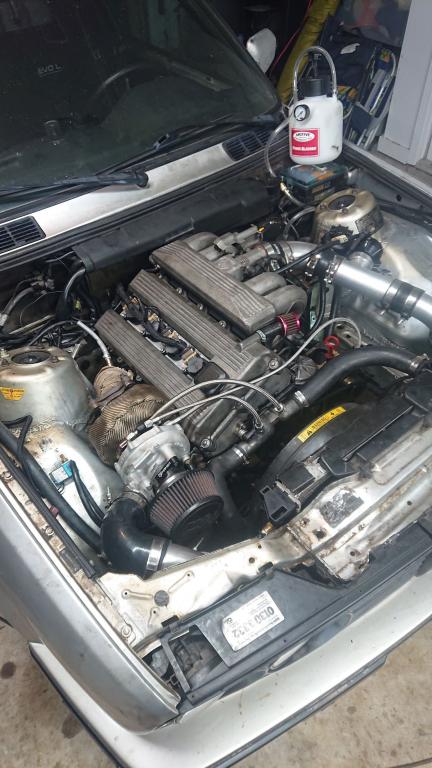

    While I wait for the new switch I checked my compression, as my tuner recommended to do on a regular basis to maintain a trend on engine health with the additional boost. With a 153k on the motor and about 700 miles with boost noises, I am pretty happy with the numbers and the state of the spark plugs.

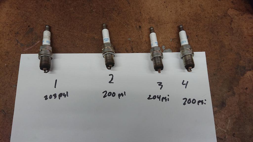

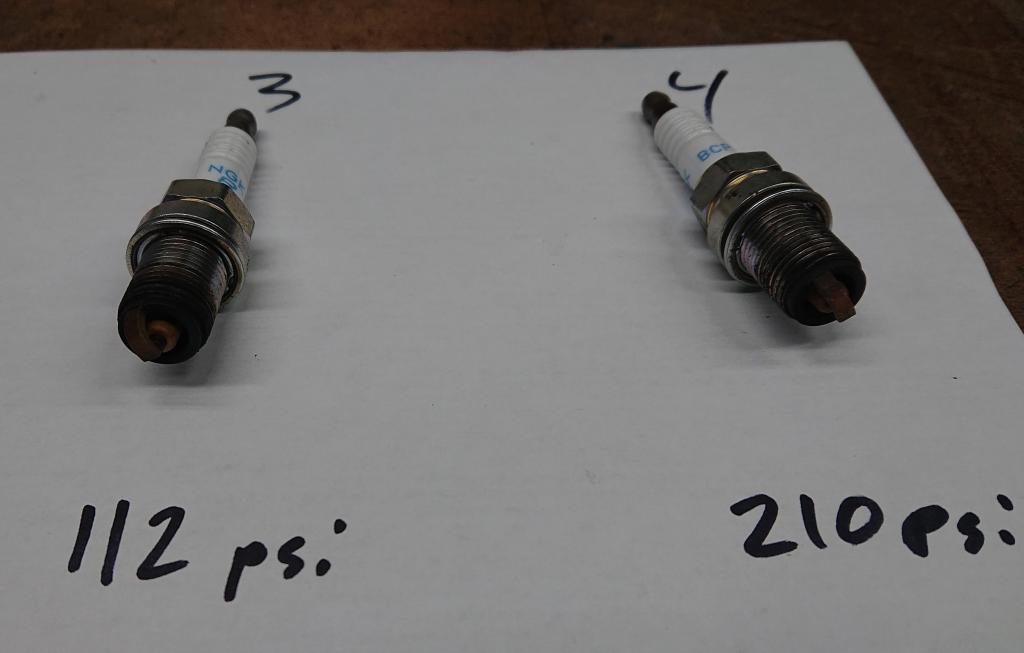

      Pulled the plugs out the next day and ran compression and low and behold cylinder number three looked a bit different than the rest...
      Click image for larger version  Name:	DSC_1995.jpg Views:	0 Size:	29.0 KB ID:	10044162 Click image for larger version  Name:	DSC_1997.jpg Views:	0 Size:	37.6 KB ID:	10044163
      The spark plug didn't look terrible and what I could see on the borescope looked fine but I am pretty sure my piston rings in cylinder #3 weren't happy with track day vibes. Any chance they just got stuck and I can break them loose or is it time to pull the engine and refresh everything with upgrades for more turbo goodness?

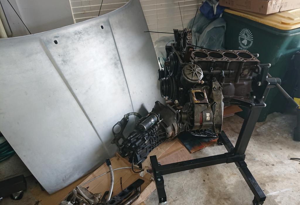

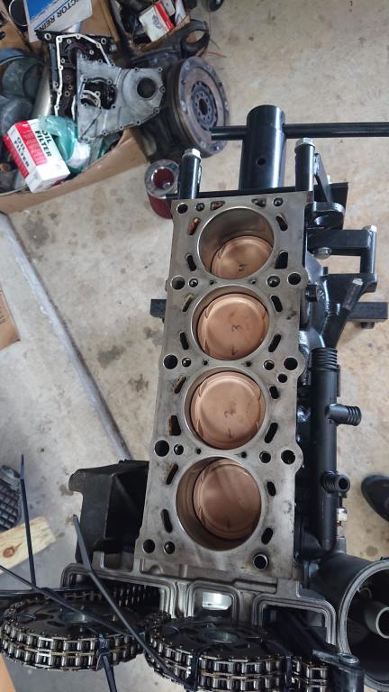

            Pulled the motor out and tore it down to see what was causing the oil blowby. Any one see anything wrong in this picture?

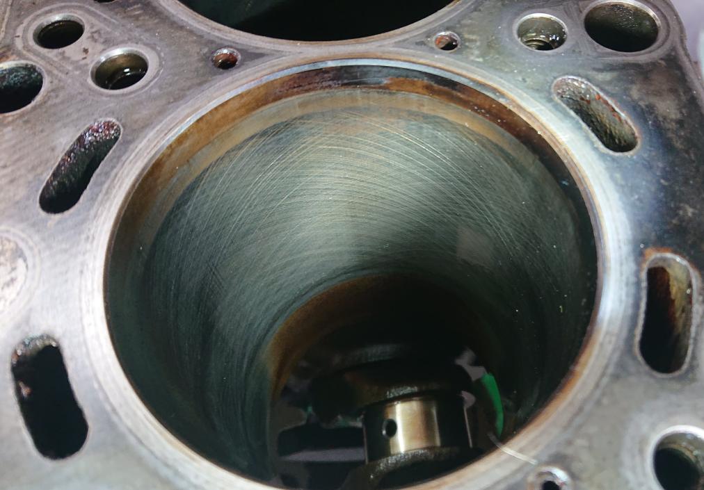

            Somehow it was staying together and didnt leave any visible marks on the cylinder walls which is crazy but pretty happy about that.

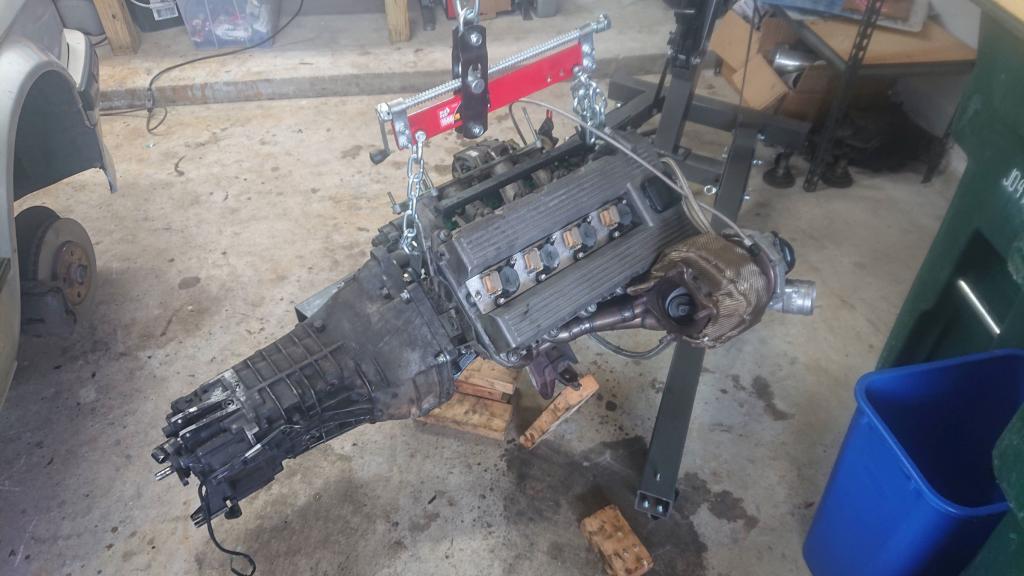

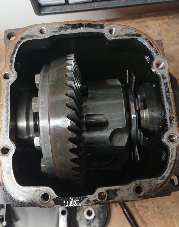

            Also pulled the transmission and rear Diff to upgrade the clutch and flywheel as well as change out the gear ratios in the rear diff. The diff was spotless inside, which was a bit of a surprise considering it was an ebay purchase a few years ago. With the new 3.25 ratio gears the backlash is a bit too tight, anyone know where I can find some different shims for the output flanges?

                Took the block and head to a machine shop and the shop owner said they were in great shape and he didn't recommend any honing or decking. That was good to hear especially after seeing a piston that was disintegrating. He did recommend swapping the injector on that cylinder since he has seen that be the reason for pistons going out.

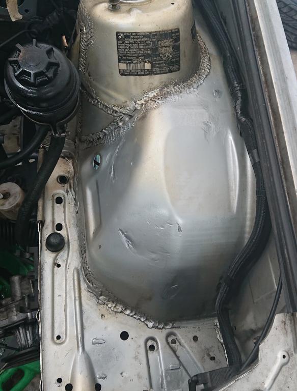

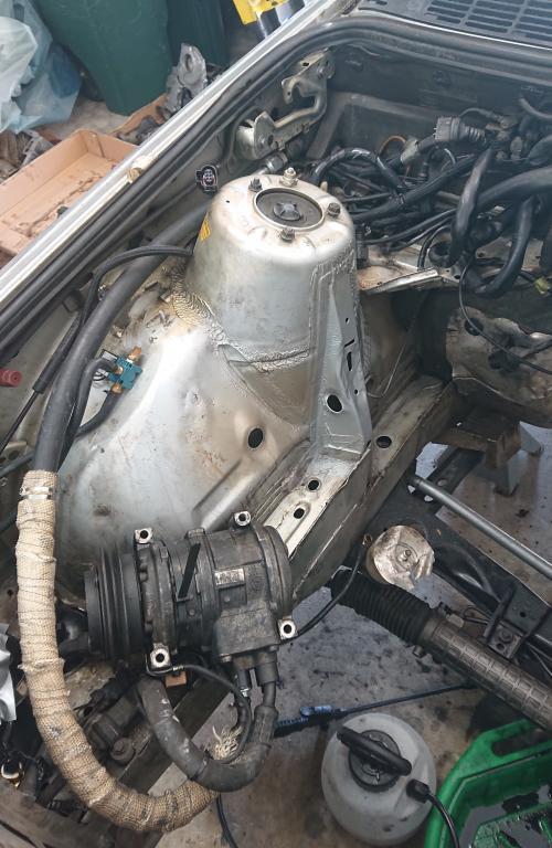

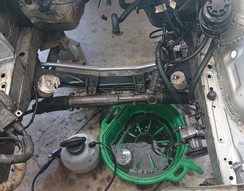

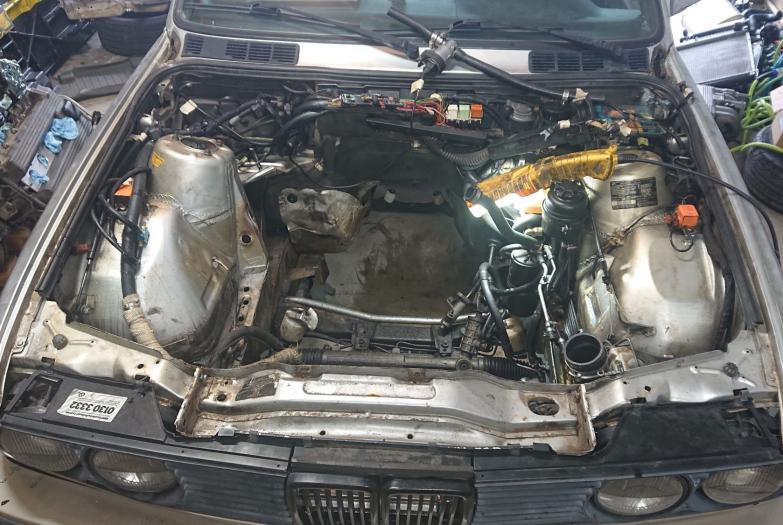

                    Did some engine bay cleaning and removed the ABS module and wiring since it hasn't worked since I bought the car and I don't want to spend the money to fix it so might as well lose the weight. Not spotless but a whole lot cleaner than it was.

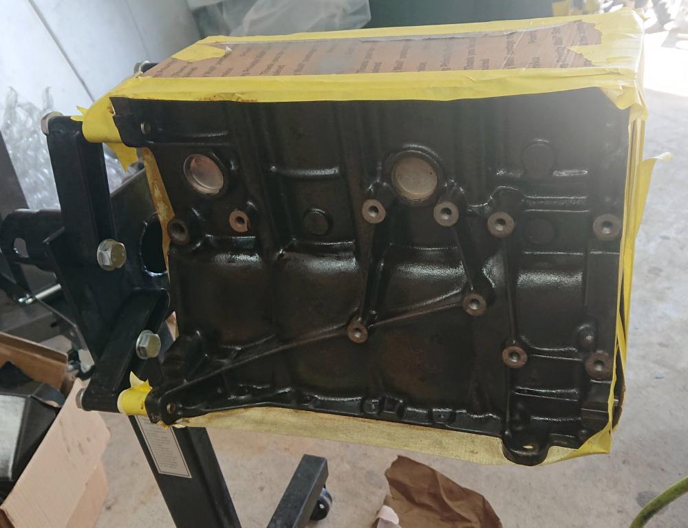

                    Also cleaned up the block and put a coat of rust converter on it in prep for painting it.
