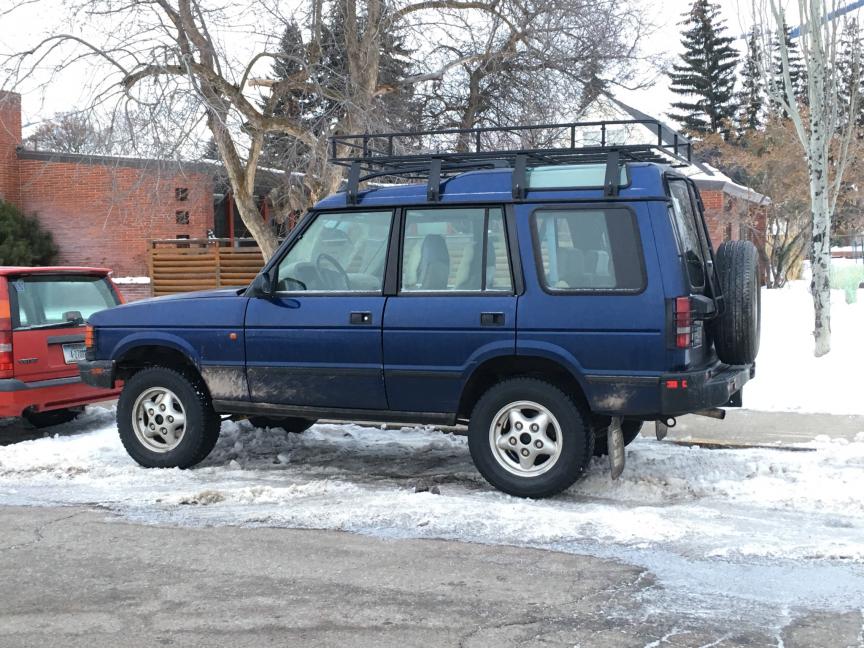

  • LateFan
    replied
    Winter mode, with skinny little snow tires on newer wheels. He says it sticks really well.
    Funny story from last week -
    He was working in a small rural hospital last week. Trying to get home for xmas. TWENTY NINE degrees below zero. Of course it wouldn't even crank. He was being polite and didn't use the parking spots with outlets.
    Took the battery out and took it inside to warm it up. Got the maint. guy to help him, so he put the battery back in in order to get it out of gear so they could drag it across the parking lot to a functioning outlet. Plugged in a pan warmer all the next day, but the cold was sort of overpowering the heater.
    Late afternoon it barely started, sputtering and cold. But it was running and he got it up to temp.
    But no heater blower.
    He bundled all up and scraped the inside of the glass and drove down the Interstate with the windows cracked so it wouldn't ice up. Painfully cold. About two hours in, the blower kicked back on and blew heat! Made it home safe but late.
    Next day here, it started just fine, everything works, heater blows warm on all speeds - yay.
