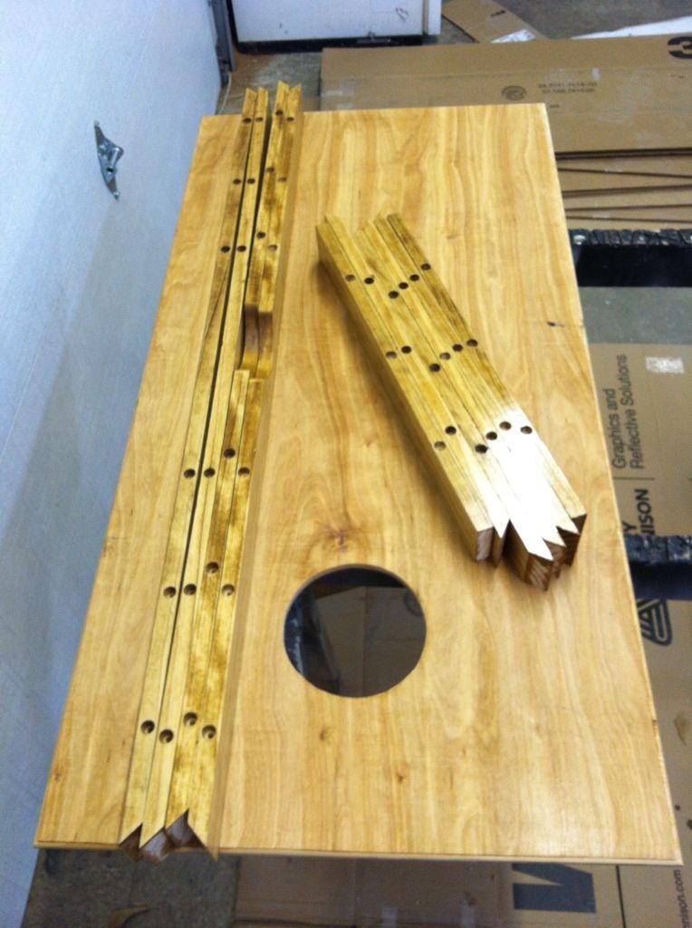

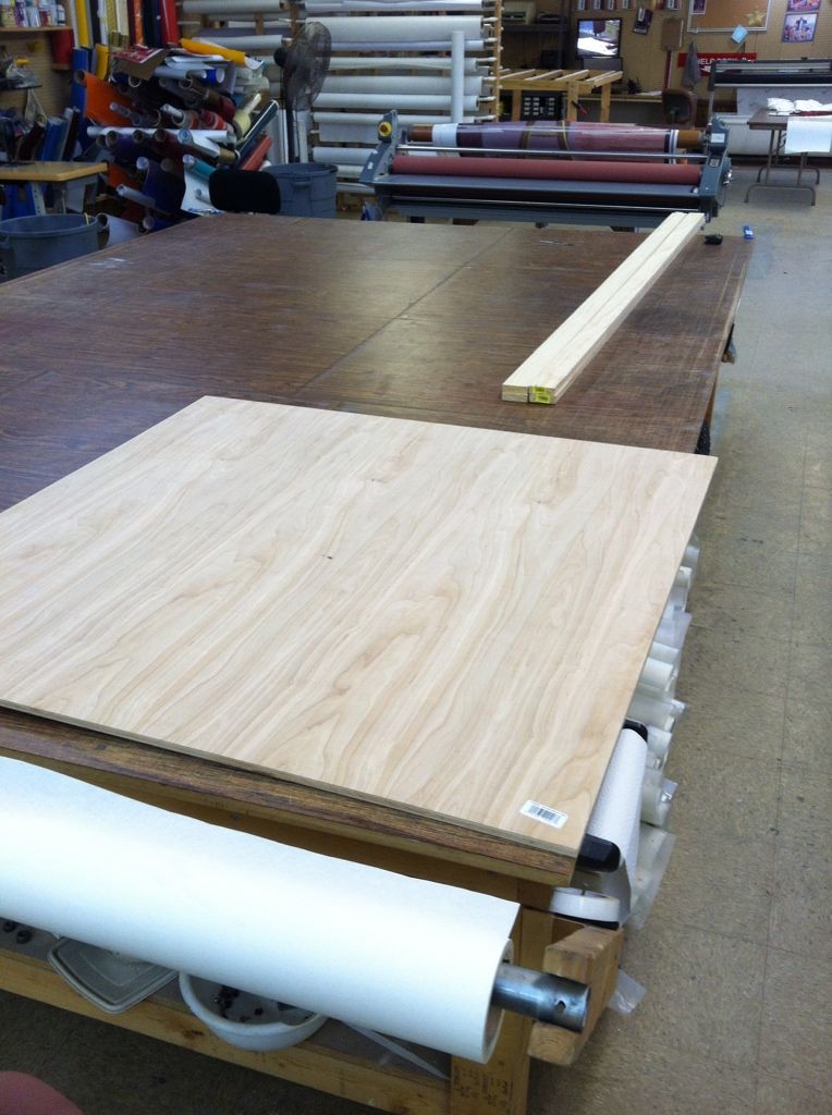

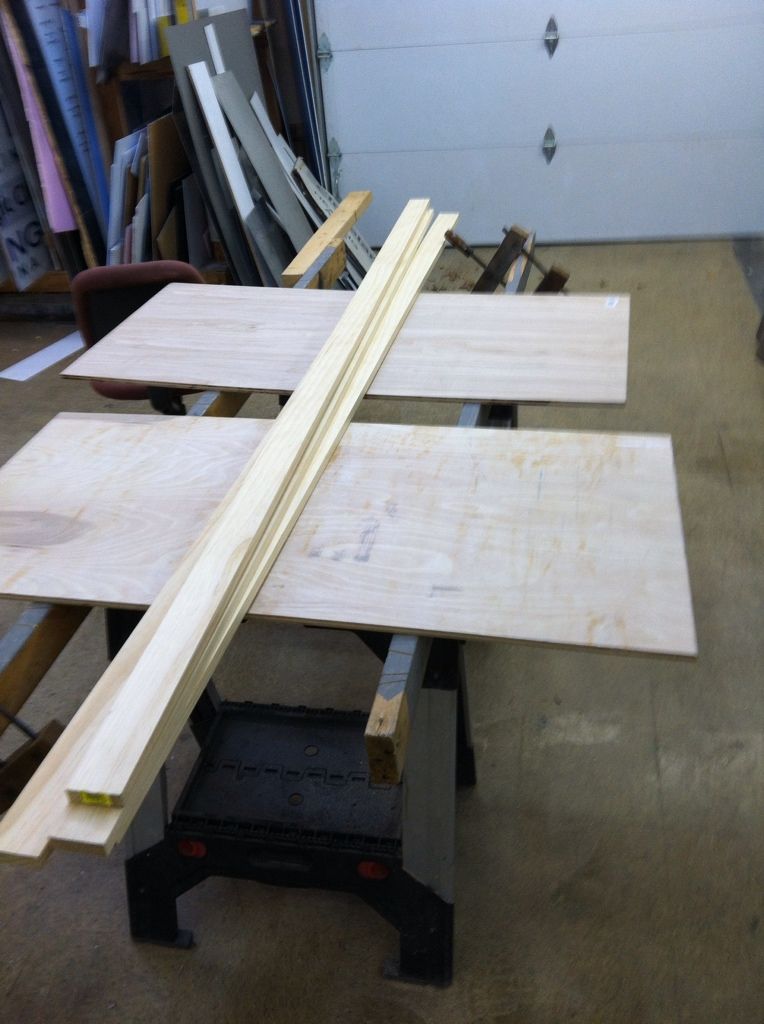

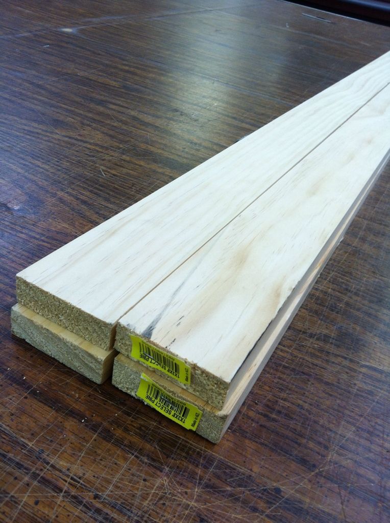

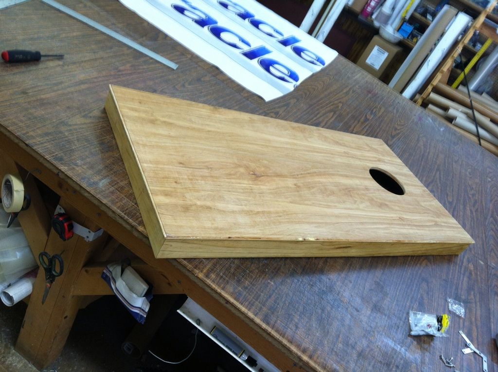

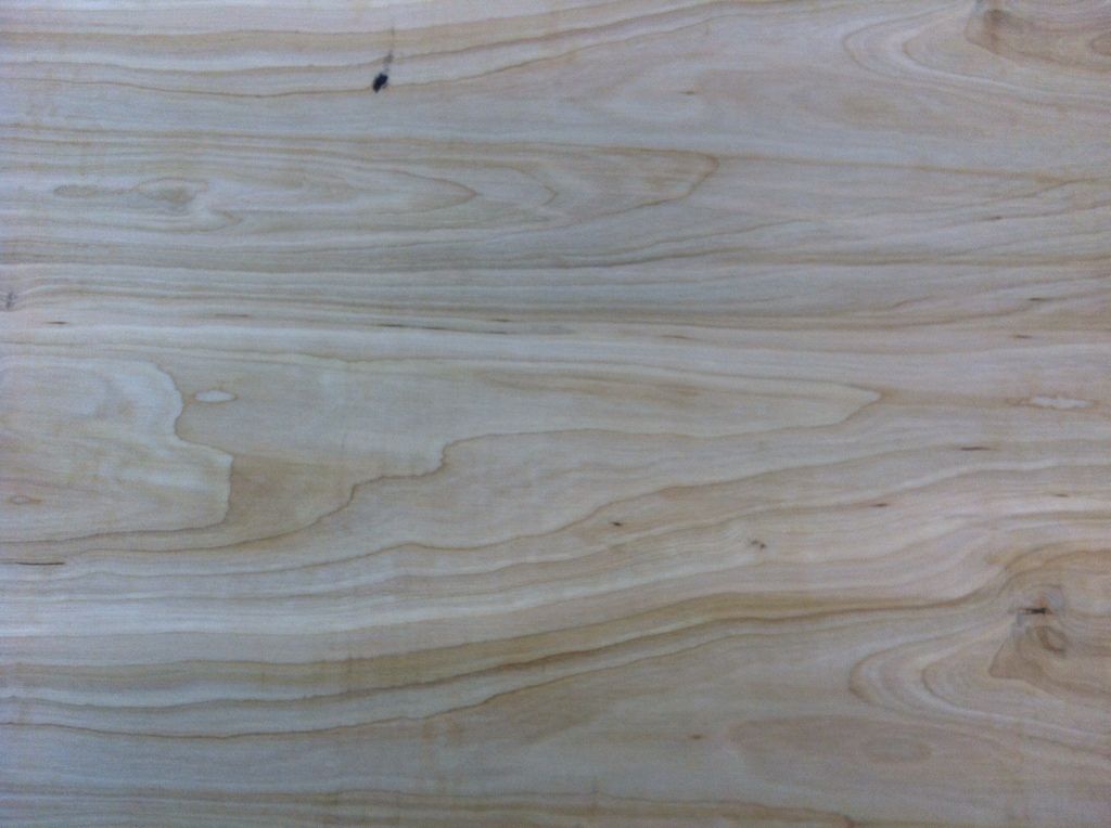

    For the faces I got a nice piece of 1/2 Birch Ply and for the legs and frames I got some 1x3 select pine planks.
    I split the ply in to 2x4 pieces for the faces and rounded the edges on all sides

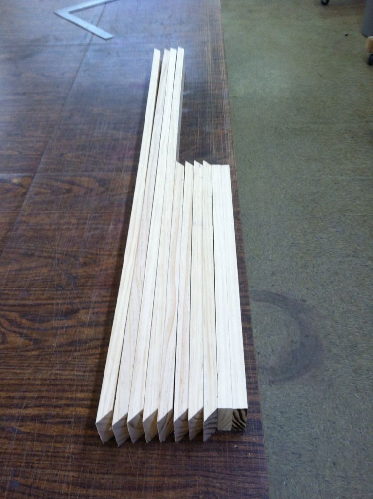

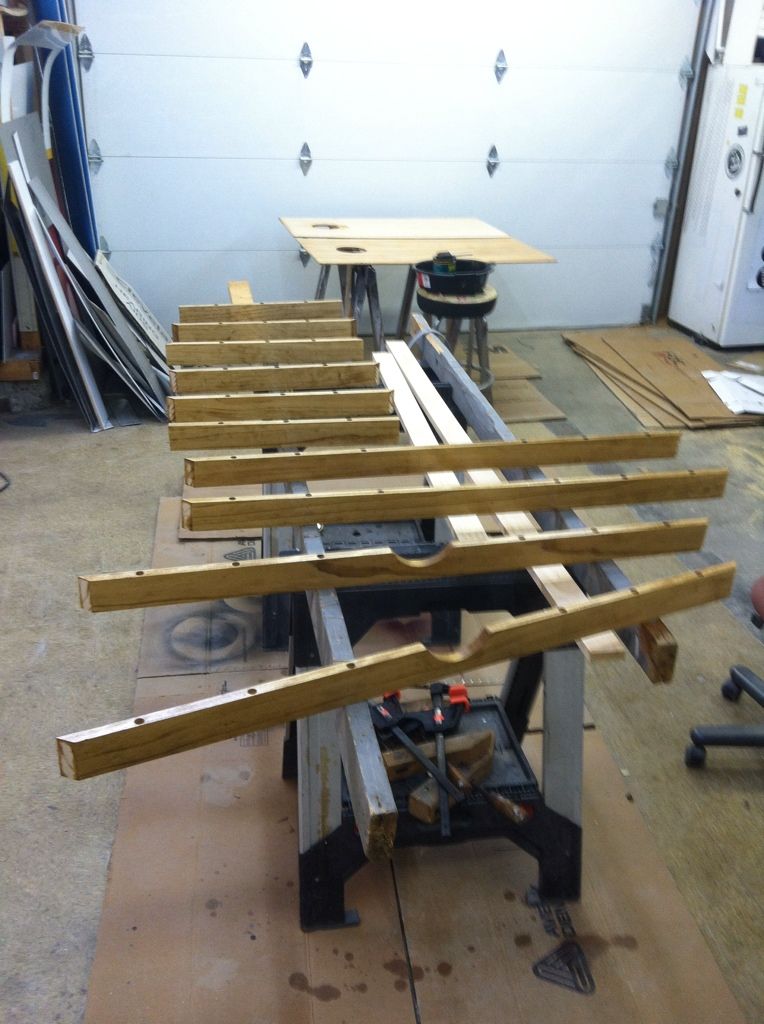

    Then I cut all my pieces for the frames. 45'd all corners.

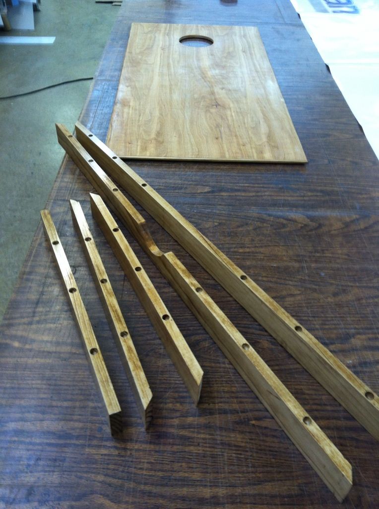

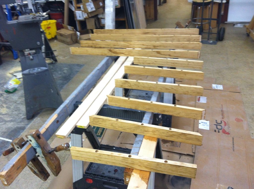

    I drilled holes to sink my pan head screws into. They will go into the bottom of the faces.

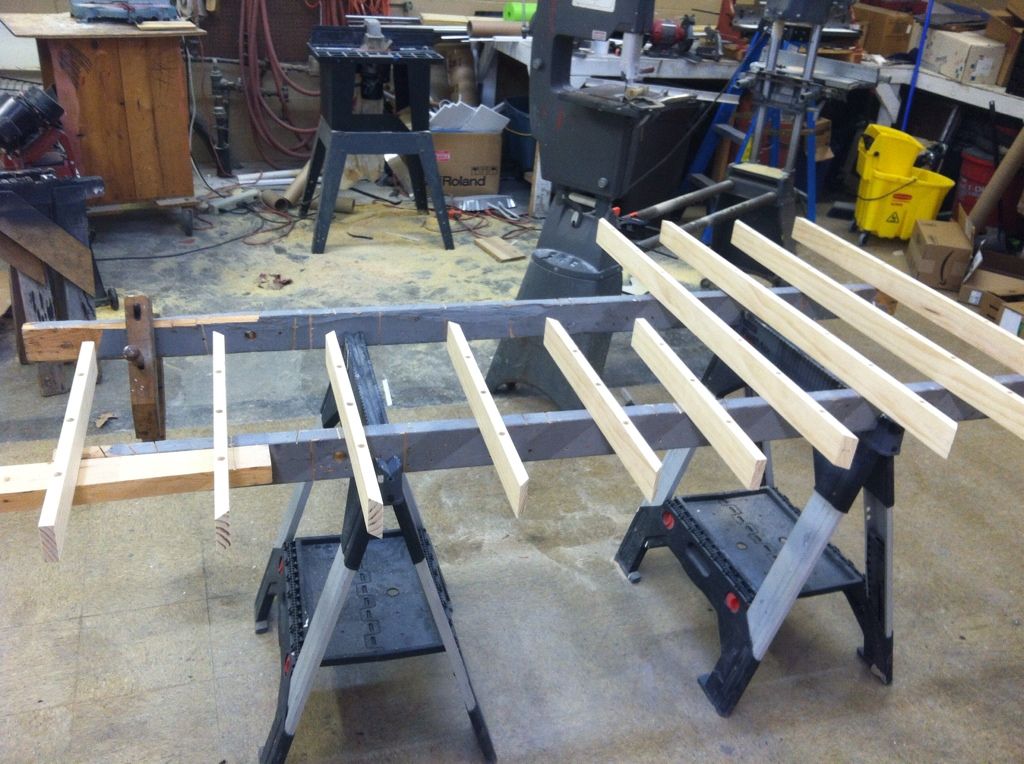

    Then I screwed all the planks to some horses for stain and poly
    I planned to wrap the birch ply faces with a graphic so I needed to put some poly on them to help the vinyl stick.

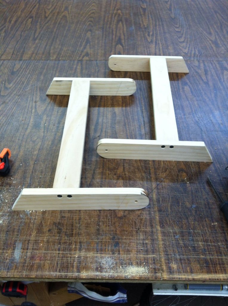

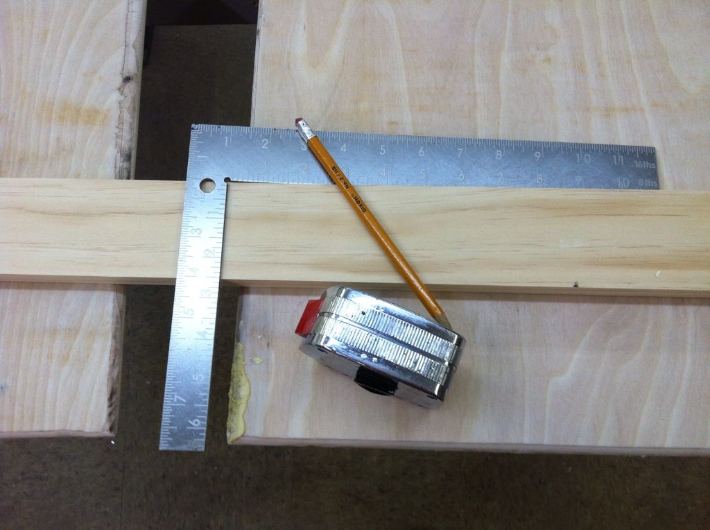

    Then I was ready to put the frame together and screw it to the faces.
    At this point, some of my screws didn't get the bite I wanted so I went around the top of the faces and put some finishing nails in all the edges. I took a nail set and carefully set each nail perfectly flush so that the nail heads wouldn't show under the vinyl and so I wouldn't have to fill the indentions and re-clear.

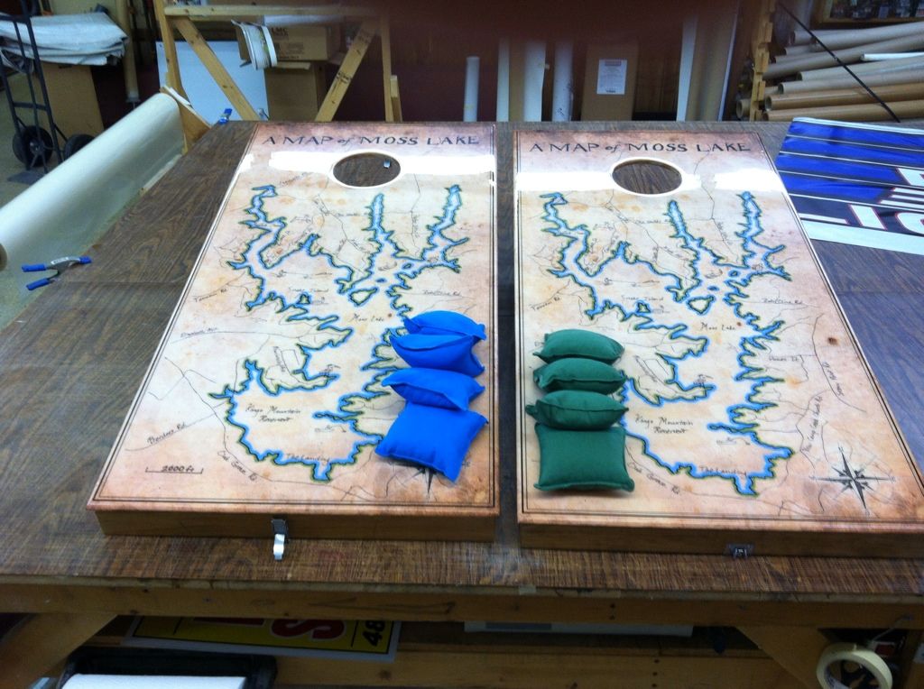

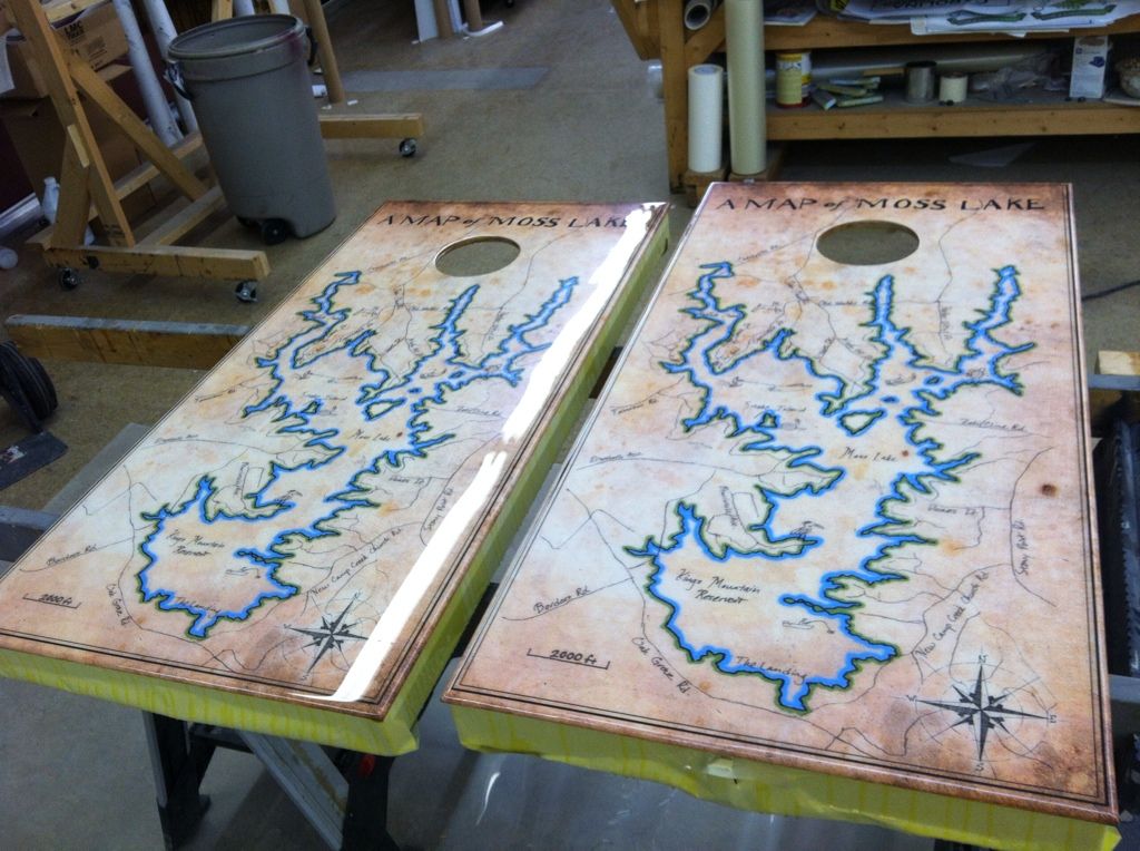

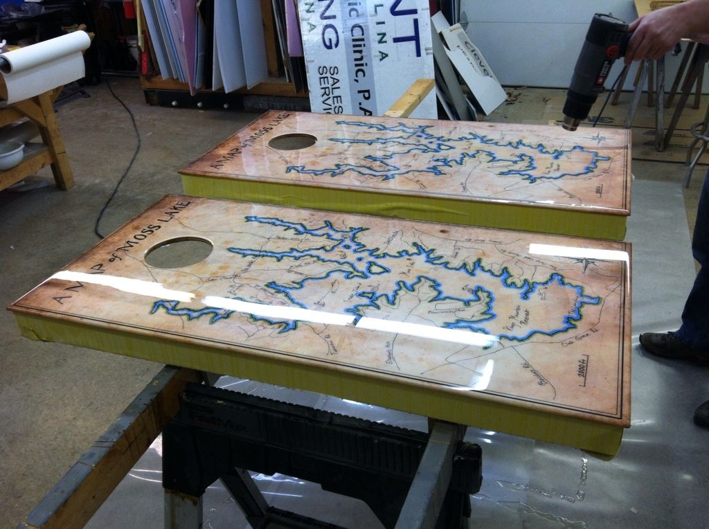

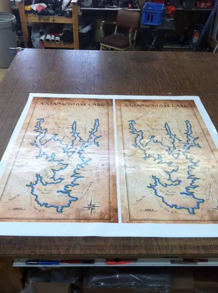

    Now it was time to apply the graphic. I wanted to make it something special for my parents so I drew a map of the lake we grew up on and scanned it into photoshop. I tried to make it look like an old hand drawn map.
    This is what they look like applied to the boards. You can see a bit of the texture of the wood showing through. I had a plan of how to smooth it out and protect the graphics from the wear and tear the boards will see.

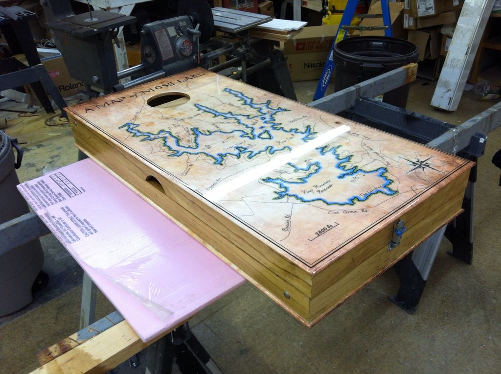

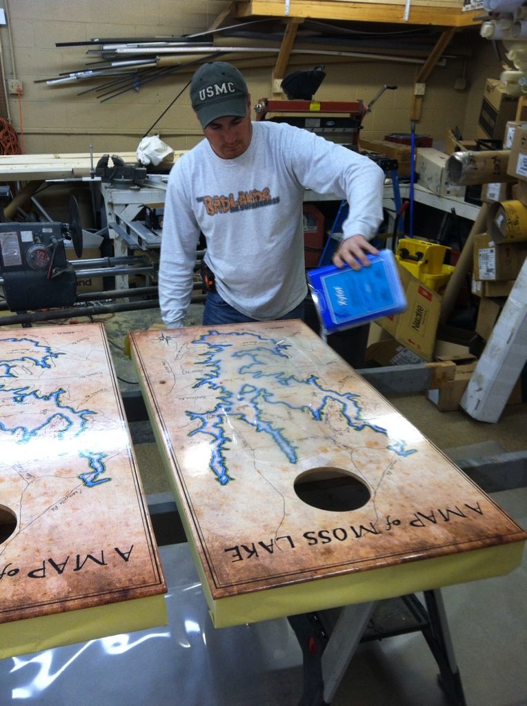

    To protect them, I found this stuff in lowes called GlazeCoat. It claims to be equal to 60 coats of varnish in one pour. Each box is a quart and a quart does about 9 square feet at 1/8th inch thick. So I needed a box for each board. I called a friend who had used the stuff before to help out. He is the one in the picture. We just used the xylol tin as a mixing vessel. It was empty and clean.
    This is how they turned out after curing for 72 hours

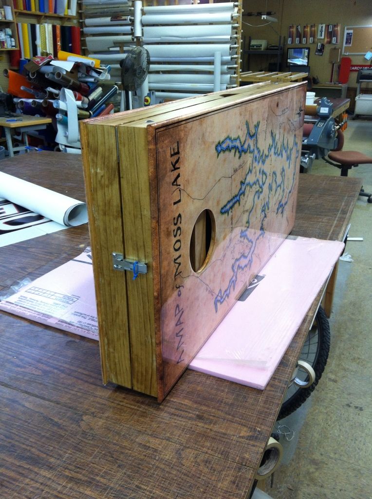

    The next thing to do was to add the legs.
    This is how they go together for hauling.

      Cool stuff - what's your impression of that "GlazeCoat" stuff after it hardened?

          Its by a company called famawood. 2 part epoxy and $25 for a quart for anyone interested.
          My impression of the product is that it is awesome. It goes on thick, levels out well if you handle it properly, and it shines like glass. When it is fully cured, it is hard as a rock.
          I wasn't incredibly pleased with my results. They look great for corn hole boards, but on a counter top, I'd do another layer on top to try and get a smoother finish. When we first poured we had a couple low spots and dimples as well as some trash. We tried to remedy it by pouring a little more on top after it had started to partially harden. It left faint lines where those puddles didn't quite level out.
          I feel sure I could do a better job now that I have used the stuff once.
          For anyone wanting to use the stuff. Get a huge squeegee, like a foot wide. Use legit new mixing cups. Don't mix it with a drill and painter stir. Just do it by hand like the box says. Once its poured you can alleviate bubbles with heat. It works really well. I used a heat gun and it did a good job but if you stayed in one place too long the motion of the air put some dimples. I'd recommend a butane torch since it moves less air but provides the heat.
          But IMO, you wont be able to get the kind of gloss this stuff gives without using some nice automotive clear. But this stuff will hold up much better

            The pics make it look 1/4" or at least 3/16 thick.....I was wondering how it hold up to scratches and nicks. And if you can polish it out with a compound.
            I have no use for it - just thought that product was kinda cool. Might be nice on a concrete counter top?

              I think it would look good on top of a concrete top. I haven't had them long enough to comment on durability against scratches and nicks. However, the guy who helped me use this stuff has had it on his boards for a while and they still look new.
              You can build it up to be as thick as you want but it will not cure all the way if you go more than 1/8th inch in one pour
              You can polish it with polishing compound and buff it out just like you would a car. For corn hole boards you need to wax it with some car wax so the bags can slide on it. Raw they will just hit and stick making the game too easy

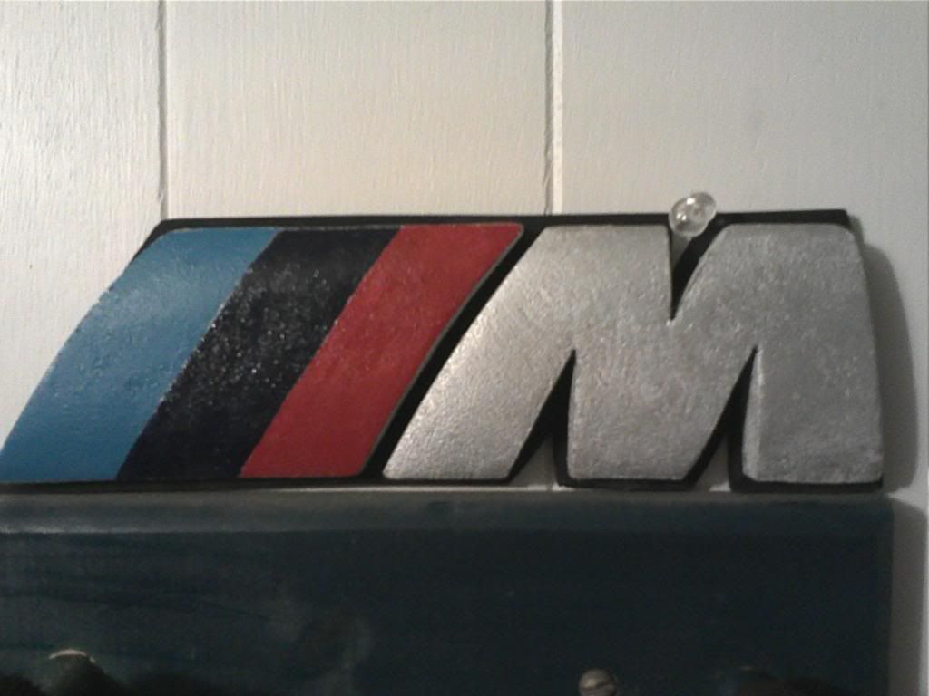

                  Some impressive work in this thread..
                  I made this in shop class during high school. It was a mold for an aluminum cast so it was made with cheap wood and I decided to paint it.
