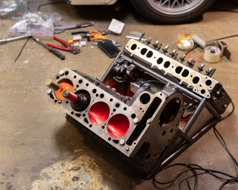

    Thank you! It's not quite done yet though! I added more lights. Will post updates soon.

              Damn guys. I've barely worked on my latest table, but I still have a few of those prior tables to post about.
              I've got a pretty cool idea specifically for a 4 cyl. One day, one day... My advice is to orient things diagonally. Straight up and down is just so boring.
              Currently building a badass coffee table
              Random stuff on insta @kevanromero
              • Chilezen
                I weld cats
                • Dec 2013
                • 1942
                #67
                Woah, I almost started posting about the next table but I didn't finish with the last one. I'll make it quick...
Name:	08 BLights-1.jpg

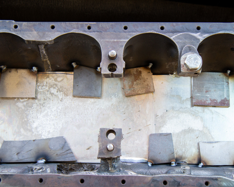

                I thought that it needed more lights. To light the cylinder bores, it's a little more complicated that just "sticking lights in there". I want it to have a nice glow, without being able to see the light source. So here's what I came up with.
Name:	08 BLights-2.jpg
                After taking a plasma torch and blasting out as much of the innards as I could, and then smoothing it down, (I think?) I glued in some basic LED strip lights. They are facing down towards the ground, which may seem counter productive. I don't want to illuminate the ground and have a 90s' sh!tbox underglow for this table. I need to keep the light contained.
                Pretty simple solution: take two sheets of scrap aluminum I found, and cut it to fit in there.
Name:	08 BLights-4.jpg
                It seals in the light, and it's just reflective enough to diffuse the light back up into the bores.
                I took the block back to work, where I would find some more scrap metal (yay!) and welded in dinky supports.
Name:	08 BLights-8.jpg
                Nope, I don't care about the dinky tacks in the cast iron. It's only meant to be strong enough to support one thing.
Name:	08 BLights-9.jpg
                We're done here. Peace

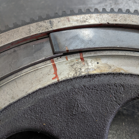

                      The goal was something simple. I'm assuming you saw the previous table I built, which should tell you I like things far from simple. But here, simple and cheap will suffice.
                      So, the goal is to mount the flywheel as simply as possible. No, I was not going to weld the flywheel to the bars.

                        Transfer the template to available sheet metal...
                        and cut.
                        Now we have a place to send bolts through.
                        Check the fitment, and, yeah, almost. On purpose! Gave myself extra metal to make sure I didn't cut it short.

                          This is easily correctable.
                          The fastest way is chop-chop
                          And then buzz buzz
                          And a little shave shave
                          ok I'll stop

                            Now we must join halves!
                            Good enough
