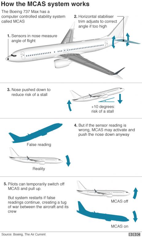

                  I didn't know this - If you know about the MCAS and know how to shut it off when it overreacts, it turns itself back on each time and dives the nose down!

                    #1539
                    Well it trims in increments repeatedly until it 'thinks' the aircraft is not at a dangerous AoA, but if you move the electric trim switches to cut out it is physically disabled because electric trim is disabled. The reason this crash appears to have happened after the crew initially turned the electric trim off (page 11), stopping the 'runaway', is the crew turning electric trim back on (page 12). This is likely because of the fact that they failed to retard power after the first descent, causing the aircraft to reach a very high airspeed, eventually exceeding VMO. At these high speeds a dangerously out of trim aircraft will have very high control forces, and timely manual trim adjustment with the wheel could also be difficult, especially with both pilots trying to fight to keep the nose up by pulling the yokes. In a panicked state, turning electric trim back on to allow retrimming with the yoke switches may have seemed like the only solution, when it's really a fatal mistake.
                    I have heard from a couple of pilots that there is a trim force reduction maneuver for runaway nose down trim practiced in sims which consists of allowing the nose to drop temporarily and trimming while it drops. In this case they did not have enough altitude to make any mistakes or to do this maneuver.
