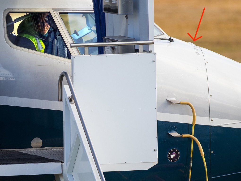

                              And a question -
                              What are these? Some kind of vortex generators before the wipers or windscreen?

                              And is it so hard to build a tough, completely reliable AoA sensor? We've been making these for what, 90 years? Or two that check each other constantly?
