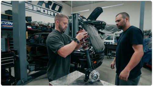

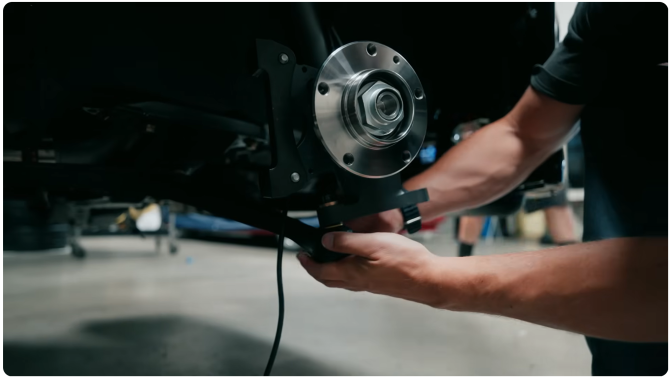

                        Originally posted by Northern
                        So what's going on here - I didn't get a good look at it but he mentioned e36 arms.
                        Are they E36 MCS?
                        So no roll centre/bump steer correction? Is he running a metric fuckton of caster? any upsides?
                        I think it's a GC fabricated front strut. GC does have a partnership of some kind with MCS if you go to GC's website, so it is probably some kind of co-developed type of deal, based on the E30 5 lug fabricated front strut. https://groundcontrolstore.com/colle...pension-system
                        If you notice the tie rod plate looks very similar to the E30 5 lug fabricated strut, but the strut tube looks larger in diameter than the kit I linked, so maybe it has MCS guts inside? Later in the video you can see it has MCS damper adjustment knobs on the top of the strut cartridge.

                        • Northern
                          I like cupcakes & sh!tboxes
                          • 5248
                          #57
                          Thanks FredK... you know you're really not as bad as they say
                          Not sure pros/cons of the strut housing vs M3 stuff - probably could do roll center/bump steer adjustments at the balljoint with GC's own offerings (too lazy to check, I assume they still offer both (edit - they do but the roll center bits are only listed under the e36)

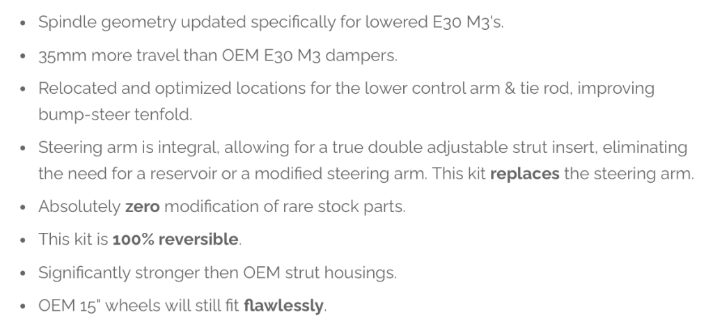

                            The GC E30 M3 fabricated struts have the tie rod location altered to reduce bump steer. You can see that it causes fitment problems with 15" wheels if the tie rods aren't the old-style E30 lower profile ones, which I do not think are available any more in this thread: https://s14net.vbulletin.net/forum/s...nd-control-kit
                            I don't think there's a huge benefit to grabbing them unless you want to avoid altering E30 M3 stock knuckles or want a plug and play setup. They are new, which is nice if you don't have the stock housings on hand, and it's always nice to see a company supporting an old chassis.

                              #59
                              Good to know. I can see the benefit of not sourcing/chopping up original E30M3 bits.
                              Tie rod issue seems the same as what's causing rotor clearance issues with BBKs these days.
                              Click image for larger version  Name:	image.png Views:	0 Size:	141.9 KB ID:	10154476
                              I mean it sounds pretty good. Probably decent unsprung mass savings since it's not 2-piece too.
