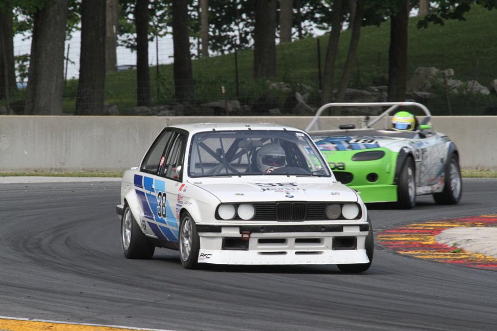

                Well, it was strong enough to take p2 at the SCCA Majors at Road America, and against some TOUGH competition!!!
Name:	Tim Schryer SCCA Majors 2018 half sized.jpg

                      That thing looks pretty legit. Whats the weight without the driver?

                        Would have to ask. It's based on what make of car you are running in EP.
                        E-Production (EP)
                        E-Production is the fastest of the production classes and features racing from classic and contemporary production based sports cars. Example cars include the Datsun 240z, Mazda Miata, Mazda RX-7, Honda S2000, Triumph TR6, Caterham 7 and the BMW Z4.
                        According to this:
                        An e30 can be between 2200 and 2310 pending modifications (p.670)
                        For comparison sake, a hard running Spec e30 does ~160whp and has to weigh 2700lb post-race with driver - 18:1 HP:WT, this car is closer to 11:1. :)
