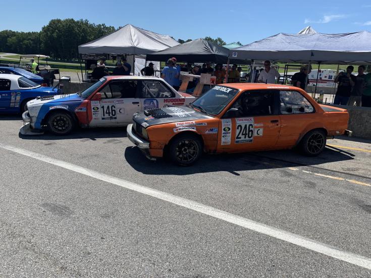

      Originally posted by ForcedFirebird
      All good points for any team getting started with champcar.
      We are well beyond that at this point. We won RAtl in '18 (146 chassis with failed front subframe photo on p1) and '19 (246 chassis I just repaired frame rails on)

        I was there. We had the Kids Racing for Life e30. You're Huggy as another handle? ;)
        Our issue was drivers. I tailed you through t10, that was the year everyone was doing aero, I lost grip. Our slow drivers were 9 SECONDS off pace lol.
        We weren't going for the win, we got Sportsmanship trophy many times tho. :)
