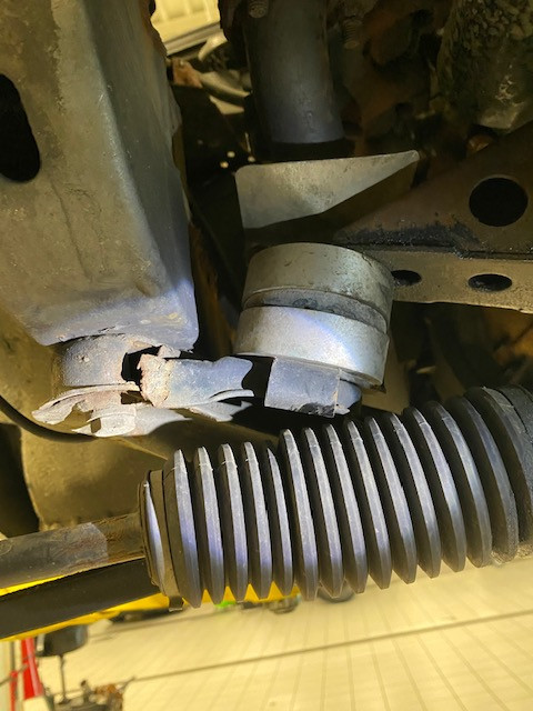

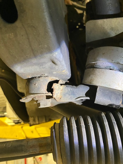

    Stock M20 running rubber mounts with reinforcement cups driven very hard in New England winters:

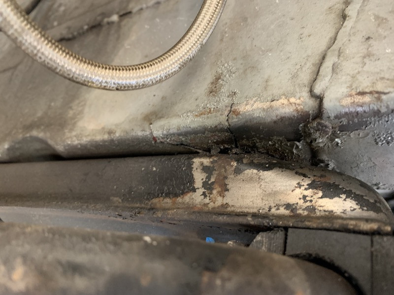

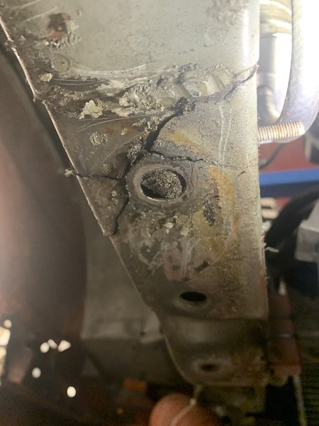

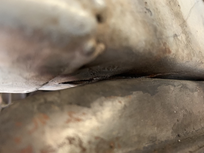

      Found another new failure today. Rear bolts on front subframe are ripping out of the frame rails. Weld-nut on the drivers side is totally detached.
      Bolts were tight but came out with no corrosion issues. Sway bar is Stock and the only thing I can think of that would apply a downward pressure to the rear of the front subframe?

        running coilovers by chance? that's a lot of transferred force!

          Dang! We ran an e30 in Chumpcar for 8 years with the same sub frame the whole time. We did have a bolt pull through the engine mount tab, but that was when the car went tail-first into a concrete barrier at Sebring ~110mph.

            Neat, you're finding the fatigue limits of the chassis. It's useful to see where it's happening as these cars age. Running it hard and using super stiff bushings was bound to do that eventually. Gotta either reduce the forces or increase the material thickness.
                              No Coilovers. Turner J-stock suspension so ~700/1100 springs
                              I fixed it so she rides again, took a couple laps of VIR this past weekend. We roll until we find the next failure. 14hours of Road Atlanta scheduled for February
