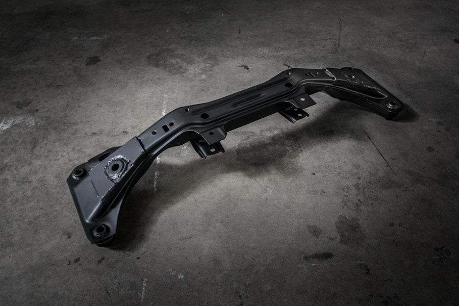

    However garagistic's reinforced subframes have a plate welded over that area, so it must be a known issue.
    E30 REINFORCED FRONT SUBFRAME Out of all the mods available for the E30, this is one of the most important modifications you should consider if you drive your car hard or plan on adding more power. The Garagistic reinforced front subframe arrives with a fresh coat of black military-spec powder coating, in addition to

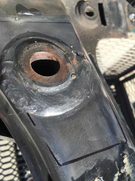

                  Here is my failure and repair. I was lucky that I caught it (twice) before it actually failed.
                  Failure:
                  Click image for larger version  Name:	IMG_6299.jpg Views:	0 Size:	44.9 KB ID:	10057337Click image for larger version  Name:	IMG_6300.jpg Views:	0 Size:	74.3 KB ID:	10057338
                  Drill Stopped and TIG crack
                  MIG reinforcement welded
                  Your subframe looks too far gone to repair TBH. I would start fresh and reinforce immediately. It does appear that a decent curb hit is what did it in, but the left side took the hit and both sides failed.
                  This repair was done in 2017 and 2018 and (knock on wood) has not been an issue since. I race ~ 60 hours per season per car on 245 RS4. Generally at the pointy end of the chump field. Not sure how that compares to your car's use case.
                  If you don't have the time/equipment to DIY this repair, there is a local shop called Backyard Bavarian that sells complete reinforced front/rear subframes, powder coated and all, for a reasonable price. Facebook/Insta is how to contact or PM me and I can send you his number.
                  -Chris

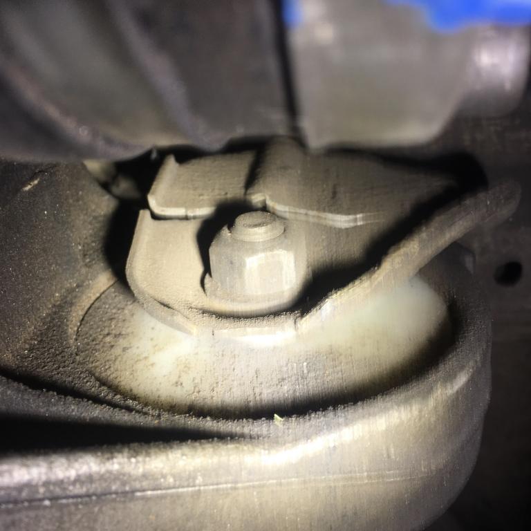

                      Ok i have a new one for y’all.
                      any thoughts on the root cause and/or necessary repair/reinforcement?

                            what subframe bushings you running?
                            @Zakspeed_US
                            • redneckvtek
                              • 60
                              Condor
