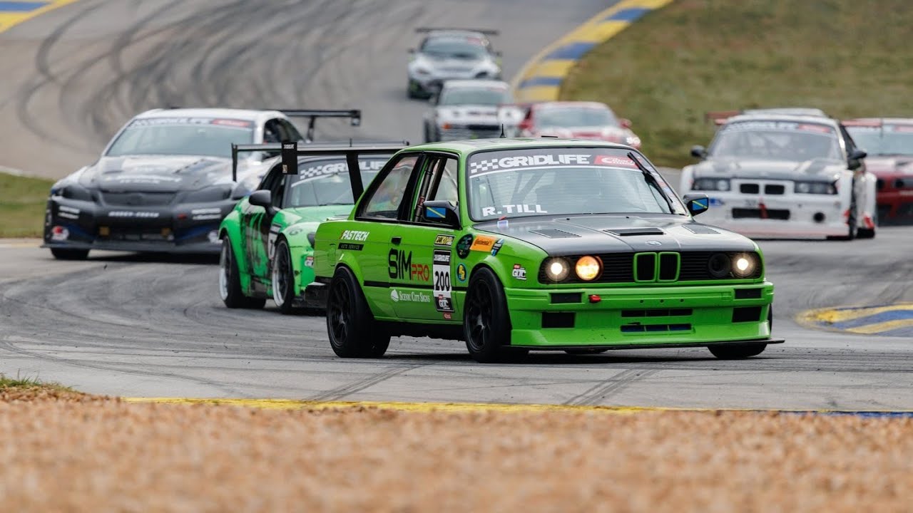

                      Anyone know what powerplant RJ Till has? Great result at RA!
                      • craz azn
                        • 749
                        A quick google search found an older youtube video denoting a 194 whp M54B25.
                        I'm quite surprised an E30 can compete that high up in the field to be honest, especially at a fast HP track like RA.
                        Rippin' Proper | Youtube | Vimeo |

                          I can talk to him if he makes it out to the last event at Laguna Seca.I shoot media for one of the teams, so I'll be there and can say hi to anyone else there.
