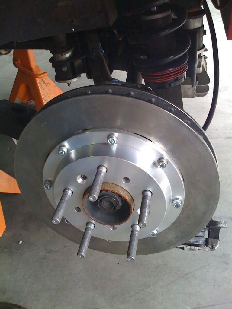

                  Originally posted by Massive Lee
                  [pics]
                  Hmm. I thought E36 rear suspension was a Z-link? Or are we talking the ti rear suspension?

                    #39
                    look closely
                        That's definitely E36 rear.
                        Here's a good example of the semi-trailing arm.

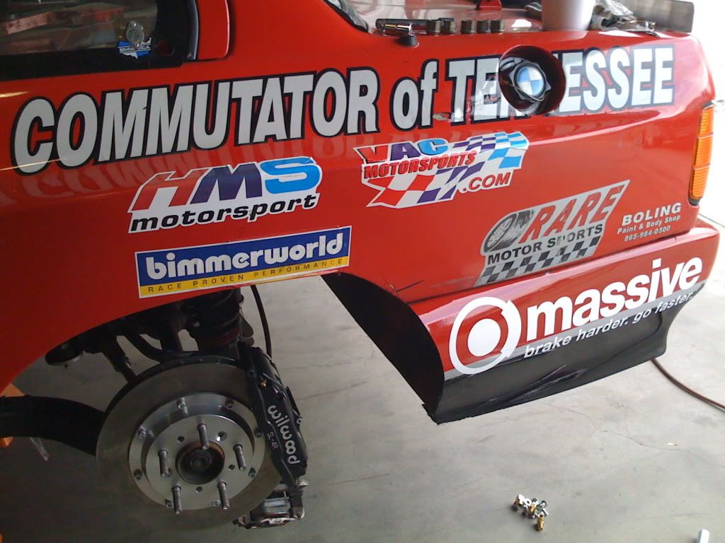

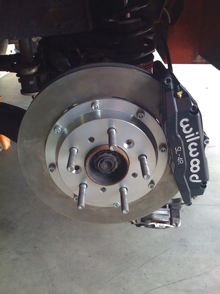

                          The #03 DM car definitely utilizes a stock e36 M3 rear subframe.
                          It also includes E46 M3 trailing arms, UUC adjustable control arms (upper & lower), and E46 M3 axles.
                          The power output of the fresh 2009 Sunbelt Engine is identical to 2008...just freshened-up after I missed a shift at Barber in November 2008 and required replacement of several valves. My lap times at several tracks improved following the switch from StopTech BBK to Massive Brakes. Lee knows what he's talking about and I'm extremely pleased that I finally heeded his advice! :D:D:D

                            #43
                            Hey Mike.
                            Welcome to this thread. Very curious about that next project. Unless you find yourself getting old and are building a competition Lazy-Boy with flares and Stickley motor. ;)
                            For people who don't know, using e46 M3 control arms offer a tremendous increase in track width. Ball joints are also bigger, not to mention that the geometry of the control arms is very friendly with lowered cars. I studied e46 M3 and standards CAs as I am about to produce a spherical bearing kit for e46 M3 CAs... I have a friend working in the largest BMW dealership in Canada, cleaning the stack of used e46 M3 CAs and piling them up for me.
                            BTW Mike probably has the fastest e30 racecar around. Whoever will buy it will end up with a winning car... And considering the costs of building and developing a racecar, it remains a bargain at the asking price.
