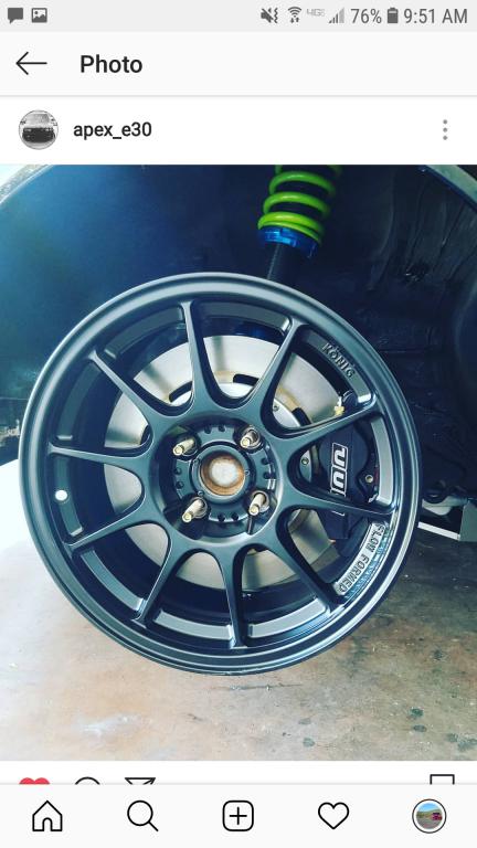

                  Anyone interested in fitting big brakes with a 15x8 should look into the konig dekagram. Only 12.3 lbs in 15x8 et25
                      Looks pretty decent actually, has anyone confirmed that this has clearance for the 300X32 kit?
                      • ahrensNW
                        • Mar 2015
                        • 1716
                        #71

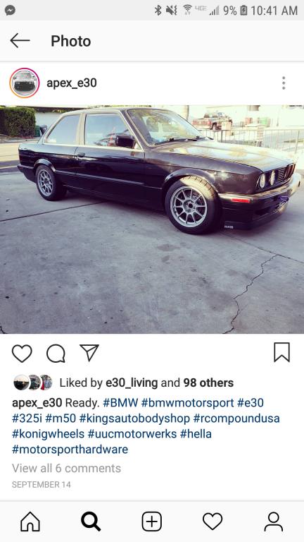

                        Found this on some dudes insta. I'm pretty sold. On sale at Goodwin racing for 129 right now too, free shipping.

                          The UUC caliper is pretty narrow and small. If this one fits, it doesn't mean that the bigger Superlite will. ;-)

                            #73
                            Makes sense. I dont physically have a wheel to check tolerances yet. Although, at et 25 a 5mm space all around shouldn't be the slightest issue.
