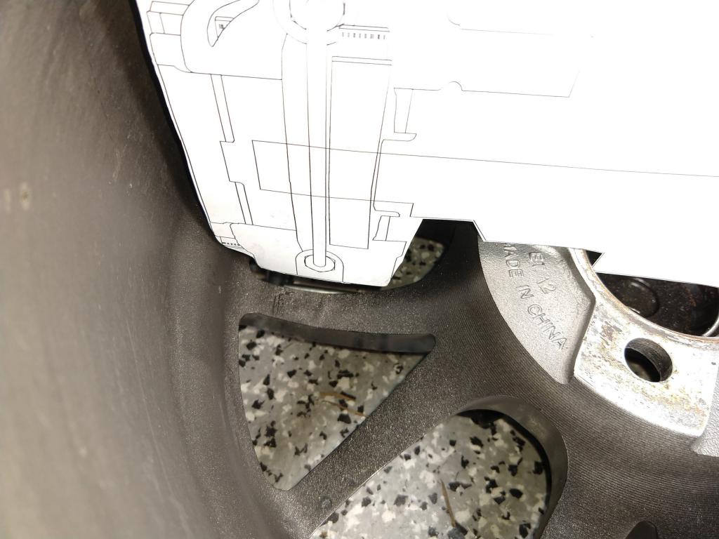

    Has anybody asked a Jongbloed retailer to test a fitment template against their wheel? They most likely have (at least) one in stock and can simply download the fitment templates, print them, cut them out and apply against one of their sample wheel...

        I am working with Ryan at Jongbloed as we speak. Running Lee's 300x32 all around, thanks Lee.
        They make custom wheels so they can do whatever crazy setup you want. I just sent him Lee's SL template for reference. I am getting a set of 16x8 ET?? 305s built. Originally I wanted ET20 because we all know its a setup that would allow 225/45s. However, this would mean I could only use a 1" lip and he had concerns about valve location and wheel balance. He wants to use a 1.5" lip but this would result in something around ET10... If Im not mistaken the wheels would poke too much to allow full usability of 225s. Im a bit confused as to what the final offset will be and how much lip I will be running. Fingers crossed they mount up first time perfectly. We will see in a month or two.

                        I'm running 15x9 Exocet. The template shows plenty of clearance on the 300x22 kit.

                              For what it’s worth I’ve tried both , 300x22 and 300x32 against my TRM 15x8 and 300x32 needs a bigger spacer than I want to run. 300x22 is close, clears with 5mm .
