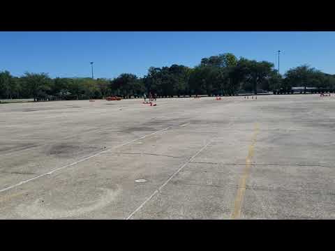

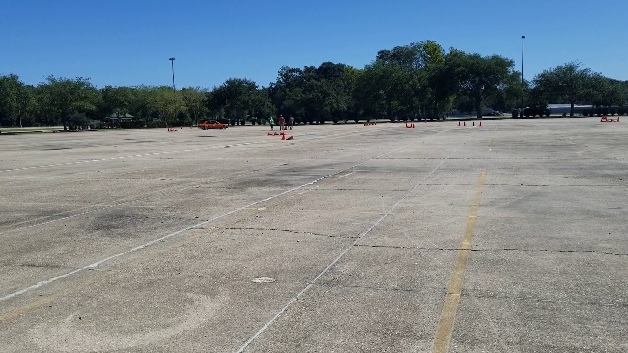

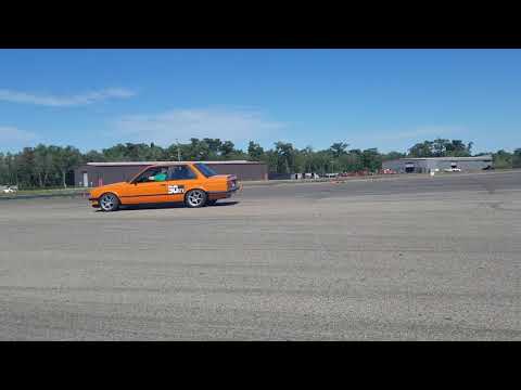

                  Friend of mine captured some great videos of the car.
                  I installed the adjustable IE links before the event.
                  Set the front bar to full stiff, and left the rear on soft, it really helped the rear stay planted under heavy throttle and breaking, it can still rotate, but is much more planted.
                  Ran higher pressures in the tires too. 36 front, 34 rear, I'll keep playing around with this, but they did better than at 30psi.
                  Most importantly I began to get more comfortable with pushing the car, and really dropped time by being much more aggressive with my inputs.
                  Fast times were low 43s, FTD was 42.5s I was running mid 45's

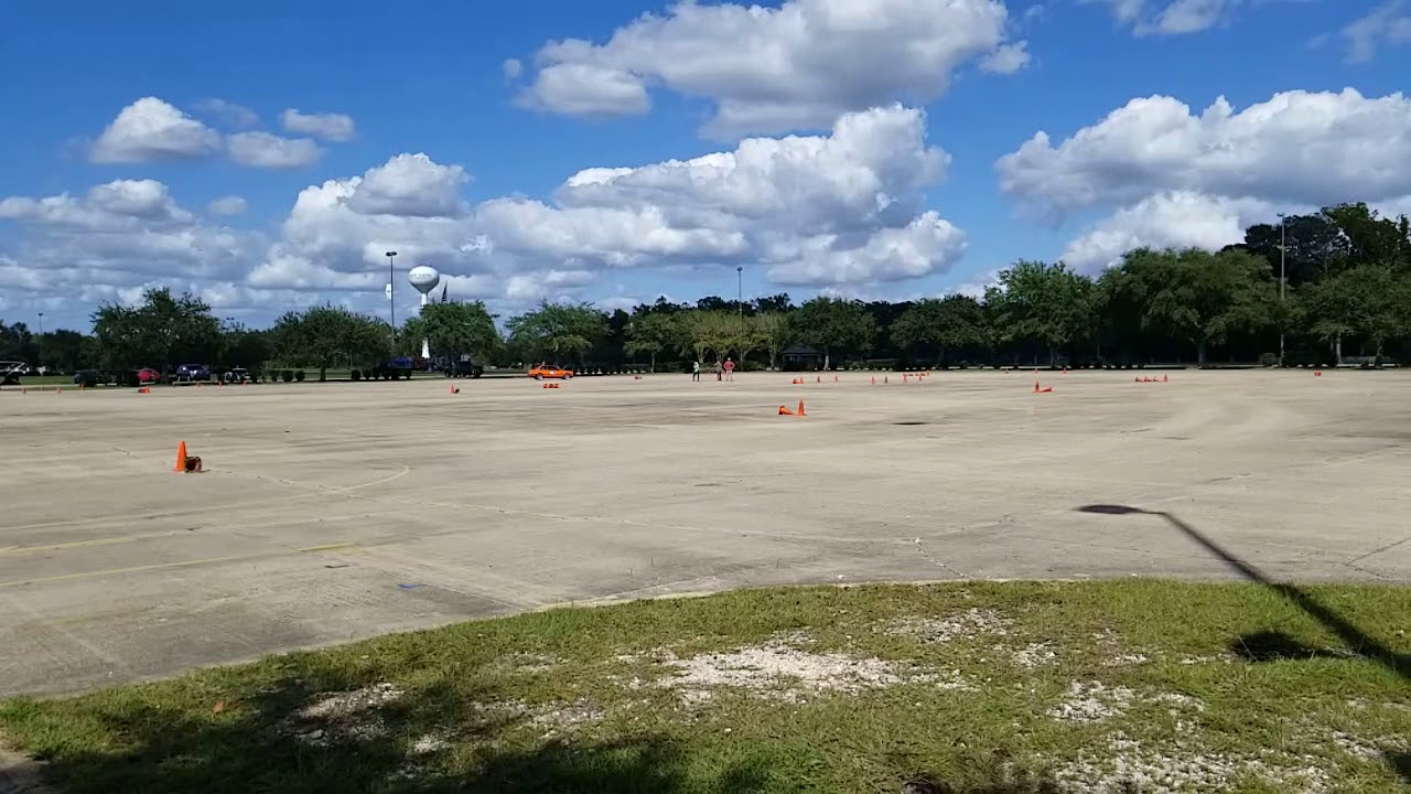

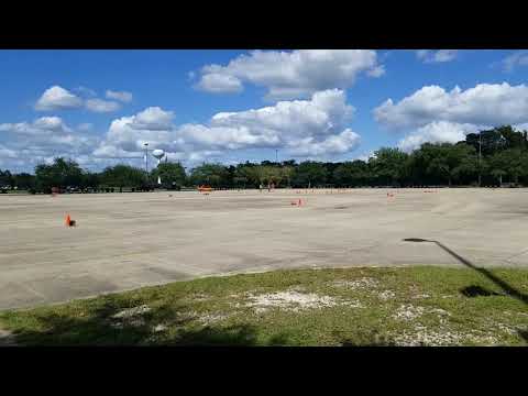

                      Finished up a 2-Day Event in New Orleans.
                      I picked up a set of 15x7 Kosei K1's and put 205/50/15 RE-71R's on them.
                      The allure of cheap tires was too good to pass up.
                      I'm finishing right in the middle of RAW times, and same general area in PAX.
                      I'm getting raw-dogged by a dude in a Mustang. SAD!
                      H&R Sports are too soft, as has been said many times before. The car is rolling around too much, I'm losing grip in the corners, coupled with the lack of raw power, it's not a good combo.
                      I'll keep running the car for the season, but over the summer break in 2020 I'll probably look to upgrade to coilovers.
                      Also, had a nasty gas leak at the overflow tank in the rear wheel well, crimp came loose, fortunately someone had a small hose clamp and I was able to get it fixed.
                      I picked up a GoPro so I'll start recording my runs, but for now all I got is trackside video.
