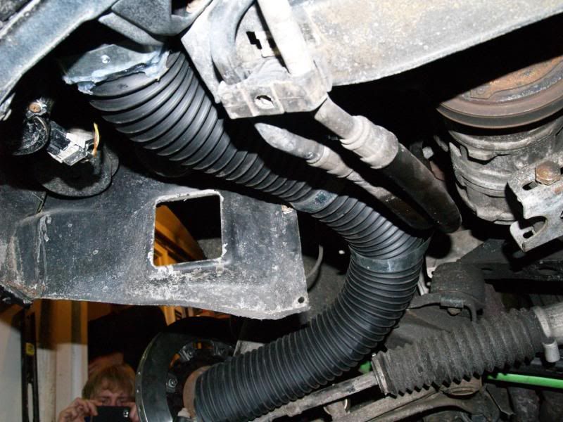

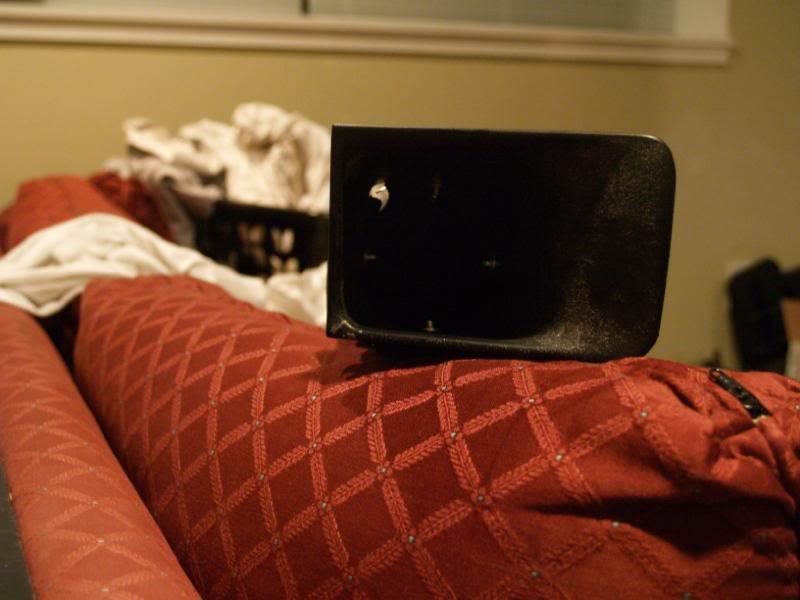

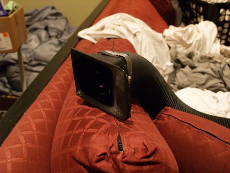

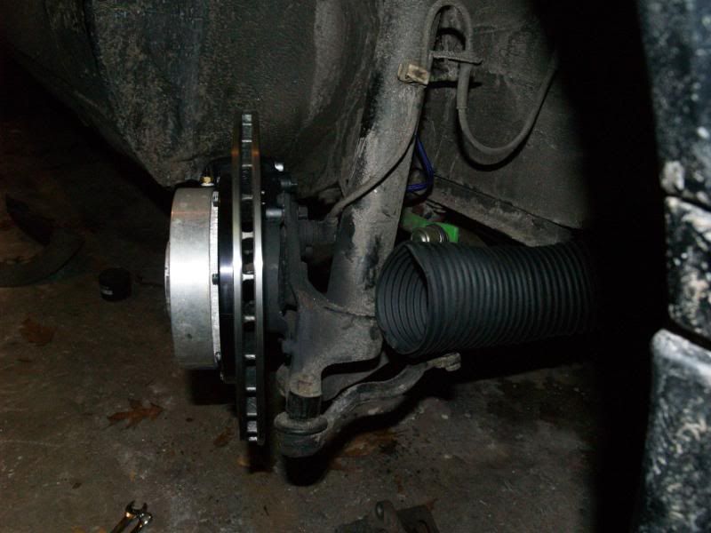

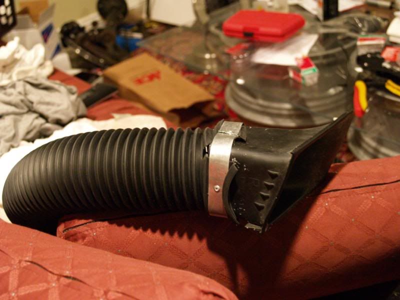

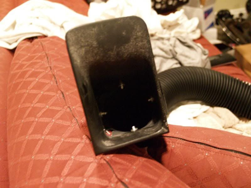

    40 buck brake duct kit
    So I bought some Allstar 3 inch brake duct and decided to make my own ducts.... The pictures below are missing the bracket where the hose connects to the strut.... I basically took the duct and ovalized it a bit for clearance and then took two worm clamps and bound it to the strut.... I have drive on them for 2 weeks and they are still perfect plus I have no rubbing.

    Looks like it will rub when the wheels turns in.
        they do not rub at all while at full lock

          1. the car is a track car
          2. the hose is always facing the middle of the rotor in the vained portion... even the hose is ovalized to have maximum surface area on the vained portion...this idea was taken from the spec 30 forums ... plus a metal backing plate dosnt make a seal so there is no reasonable way you can say the air is directed into the center at all times... its probably just insulating a layer of hot air between the rotor and itself
          3. the car comes with stock brake ducts thus by directing the air into the wheel there is less lift.... yet i feel that the difference is negligible
