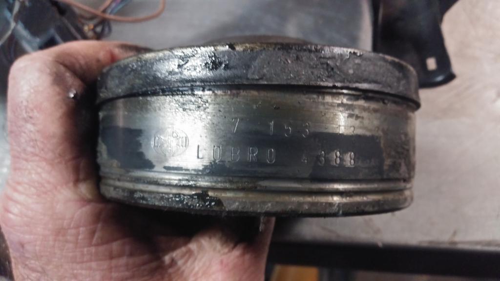

                      ^^^but when you purchase boots/axles from BMW themselves they are actually GKN/Lobro (OE supplier), so that is odd.

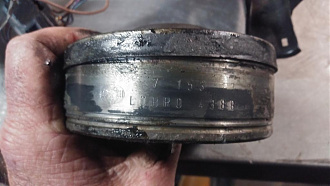

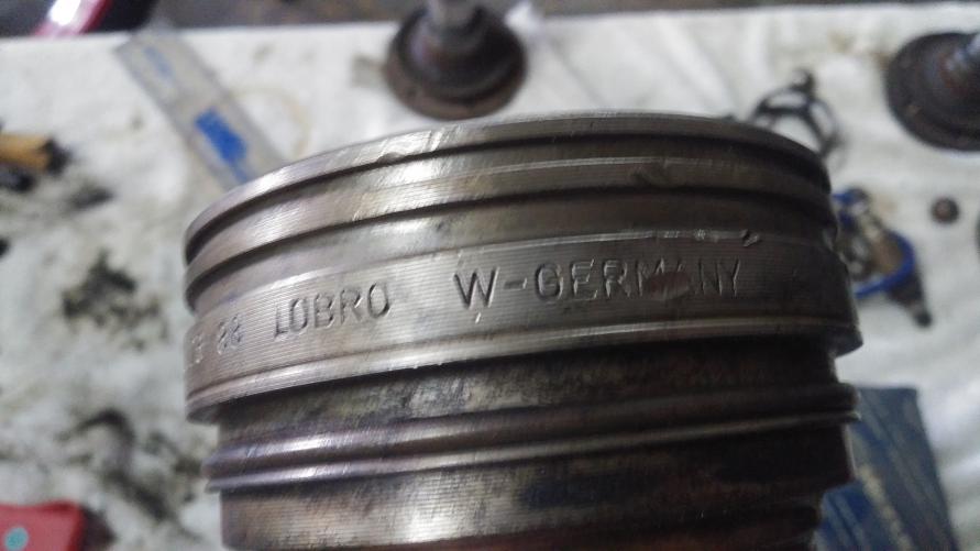

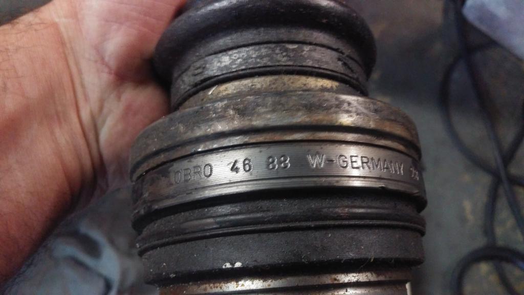

                      I just went back to my box of used OEM axle parts, and thought I saw "Lobro" on them - well they all have "Lobro West Germany" engraved on them. Right next to the BMW part number. I have 10 or 11 OEM axles and one from a box store in various stages of disassembly, they all have the logo (except the aftermarket, it's completely blank)...

                            Those pics I posted are from OEM axles - just had to clean the paint off to see it. Not sure how it's "not" BMW? Just like a genuine BMW timing belt clearly says "Contitech" right on it. Just like any other MFGR, BMW designs the part, then hires a third party to make them. Febi/Bilstein, Cortico, Contitech, Bosch etc are all "genuine BMW" parts but also make parts for many makers. No different than AC Delco parts on a GM, Motorcraft parts on a Ford etc.
                            ZF is not mfgr'd at BMW, but is genuine BMW - but - the same R&P in BMW's are in MB's/Dodges, and even now the new GM RWD platforms.
                            I would be wiling to bet if you go to BMW and get a "genuine BMW axle", take it home and clean the paint off, it's going to be the same exact axle with the same engraving. They just take them out of the box and put them in a bag with a BMW part number on them.
                            Now you have me curious. I have a couple e36 m3 and z3 axles, if I have time will go see if they are also are Lobro.

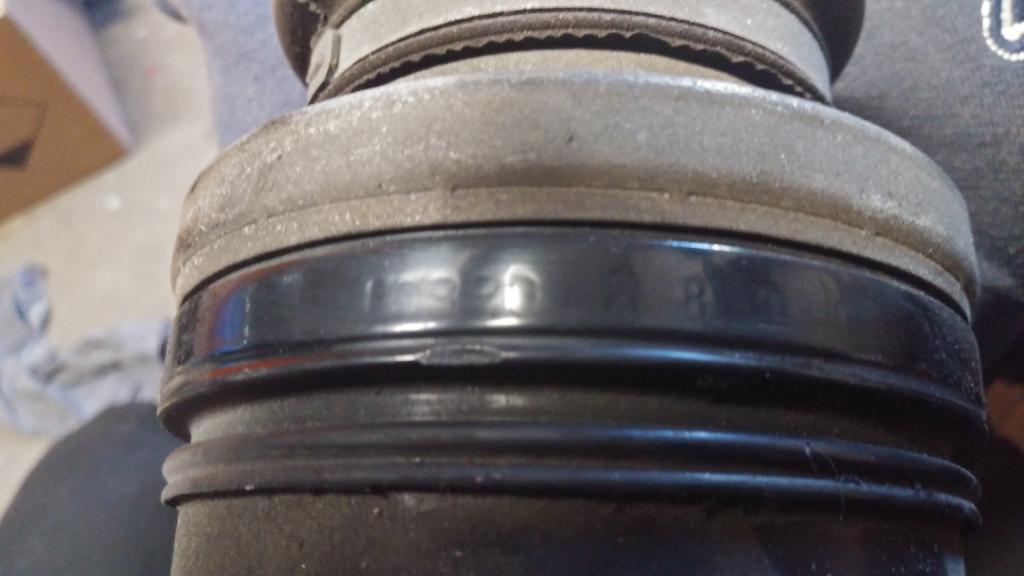

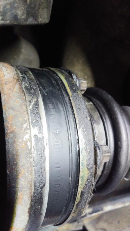

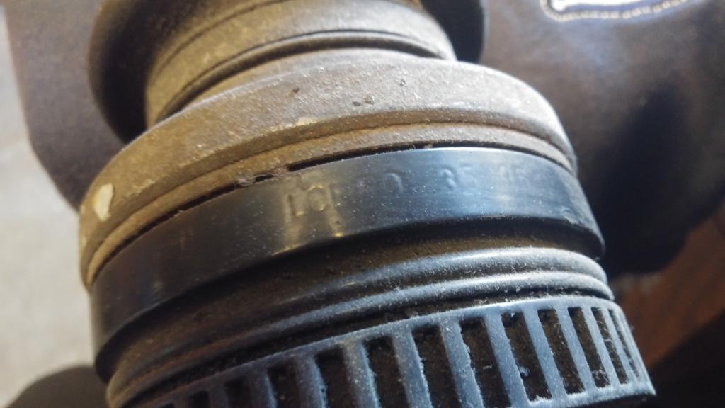

                            • ForcedFirebird
                              • Feb 2007
                              • 8300
                              There's ~15 cars here ranging from an '82 e24 to '02 e39.
                              318ti
                              Click image for larger version  Name:	20200109_133530.jpg Views:	0 Size:	60.4 KB ID:	9897671
                              e39 528 sport wagon
                              Click image for larger version  Name:	20200109_135355.jpg Views:	0 Size:	53.0 KB ID:	9897673
                              e39 540i
                              Click image for larger version  Name:	20200109_135831.jpg Views:	0 Size:	43.5 KB ID:	9897672
                              As many cars as I could rub enough grime off the CV to read them, all have Lobro on them. Weather or not the boots are different from BMW to GKN/Lobro is beyond me, but all the axles are definitely made by Lobro.
