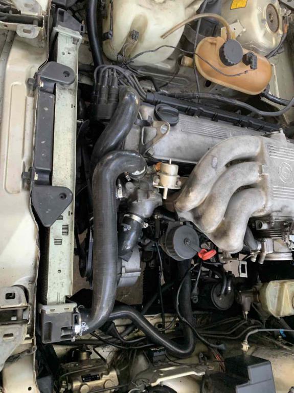

      Official SoCal PARTS For Sale Thread
      Originally posted by yert315
      You can run your early model cooling system with a late engine. You just need the early model water pump. There are no provisions to mount the late model expansion tank in the early chassis (doable, but not clean imo). I prefer to leave the eta cooling system as it tends to bleed easier than the late style.
      If you’ve already mounted a late water pump and just want to buy all the late model cooling stuff, then oh well. Just throwing an option out there.
      It’s a late model engine so it already has the late model pump. My only obstacles are getting the expansion tank. Also since it’s the early model wiring harness does not reach the temp sensor. Also had to change the intake manifold to early style cause the 6 injector plugs had no where to go on the early injection rail. I don’t even know if it’s going to work :/ also I already have late model hoses. If it don’t work I’ll probably just do it that way because I do have all the early model stuff except the new hoses. Click image for larger version

        #5418
        Did you replace the timing belt/water pump already?
        You can NOT use the eta wire harness with the late engine. It sounds like the cooling system is the least of your worries.

          #5419
          His is a 87-IS

            #5420
            Originally posted by 2mAn
            His is a 87-IS
            Ah okay. Still would have been easier to just swap to an early water pump

              #5421
              Thanks a lot for clearing up the wiring harness question. Yes like he said the water pump is late model it’s all hooked up now except for reservoir. That really shitty about the harness tho. I guess I’m in the market for a late model wiring harness :( like I said I swapped the manifold so the injector wires will match. I’ve had people say it should work but I trust NOT over should. Thanks a lot.

                #5422
                I may still do that. However I have some really nice Hoses for the late model.
