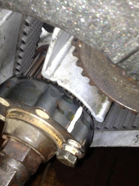

            Holy shit! Ya lets hope it is.... Click image for larger version
            Getting back in there.

                So the crank has to be lined up with the indent as shown in picture correct?

                  Yuss. Also check the crank pulley against the timing cover.

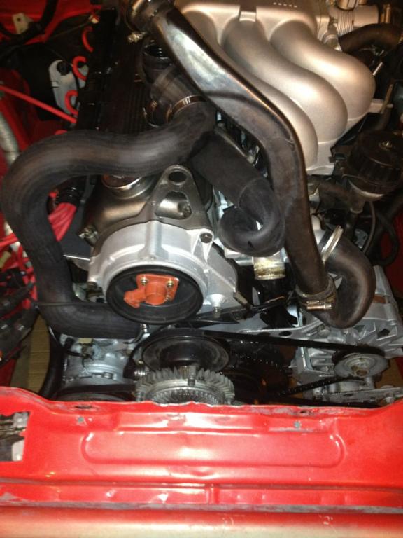

                        [ATTACH]69249[/ATTACH]
                        [ATTACH]69250[/ATTACH]

                          Looks good, sir.

                              Alright got it on now. Spun it around. It comes back in line. Last time I put it on... It didn't wanna go on.. So instead f looking why .. I just moved it a tooth over an she went on.. This time I found the reason it didn't go on.... Tightened the tb there and slipped it on. I already know this is going to pay off if all my bales are good! Yay!
