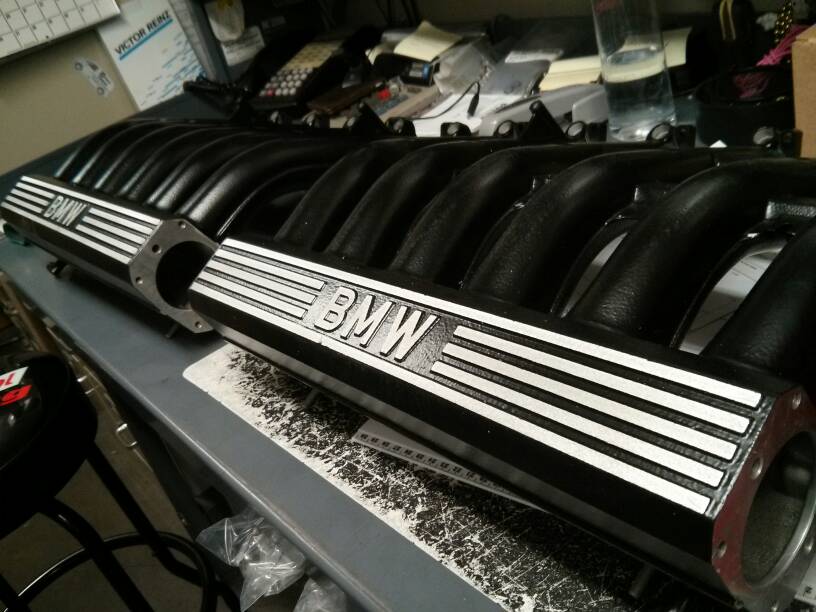

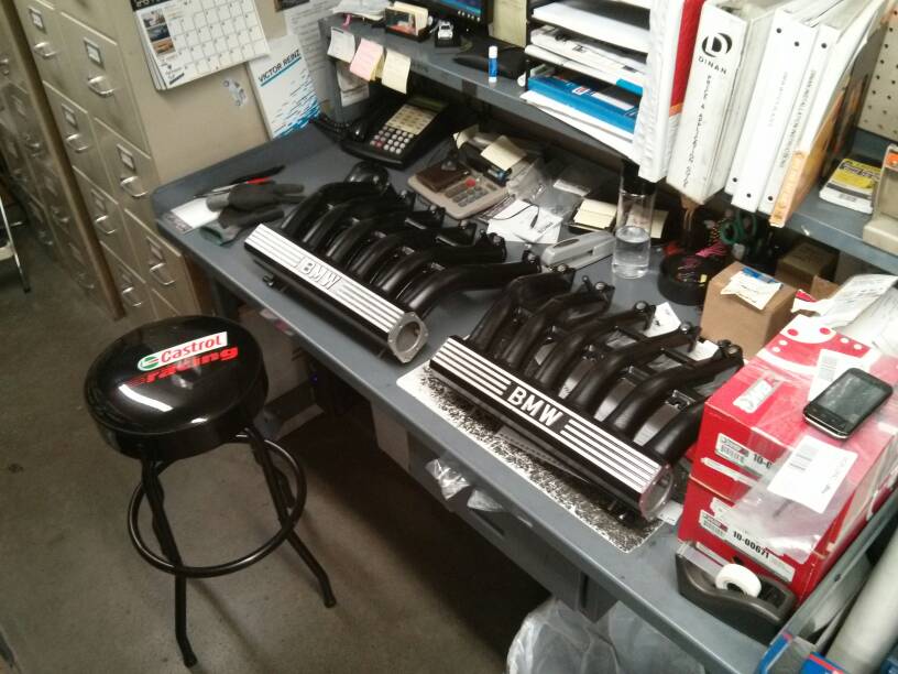

                              Excuse my mess of a desk! Dinan Intake Manifolds for a E31 850CSi back from extrude hone services, AND powder coating. Fresh!

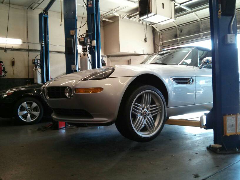

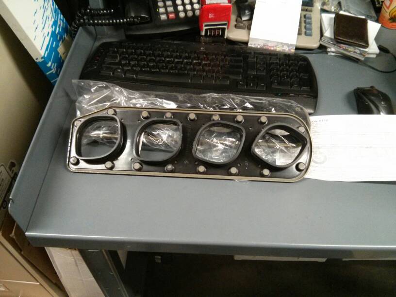

                              Also doing intake manifold flanges/gaskets and reinstalling a new Dinan Clutch Kit in a Z8!
                              The car.
