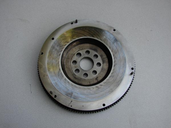

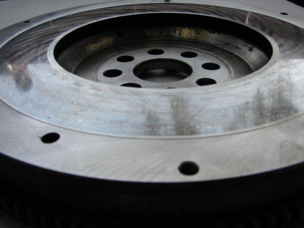

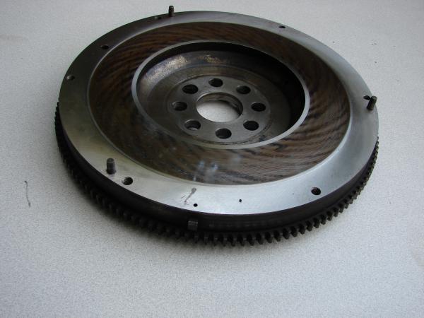

              Hey, can you guys give me an opinion of this flywheel surface for our swap project? It's a single-mass eta. Has machining swirl marks, but what about the dark markings?

              Is there a minimum thickness where a flywheel can't be re-surfaced again?

                I have ran worst, no slippin
                Resurfacing is cheap though, when I'm being a cheap ass I sand it.

                    Send it to a machine shop for $50 and forget all about it. Not worth the risk of having it be slightly warped and find out when you've got it all assembled.

                      Whoever ground it last time hadn't trued the stone in a while!
                      I'd have that recut.
                      I've even done it in a lathe...

                          Thank you my doods - the NAPA here will resurface a flat flywheel for $27!

                            What do you make of this comment on E30Tech from 2014? It's discussing a 240mm i flywheel.....
                            "You can totally remachine that flywheel. Just make sure they keep a .011" step where the cover plate bolts to. You cannot simply just machine the entire surface flat all the way across."
                              I believe it is elevated for the clutch disk surface... I am pretty sure the Bentley mentions having the .011" step...

                                I don't know the reasoning, but it is there for a reason. However, I had a machine shop resurface one for me a few years back and they completely eliminated the step...still works fine to this day, so...
