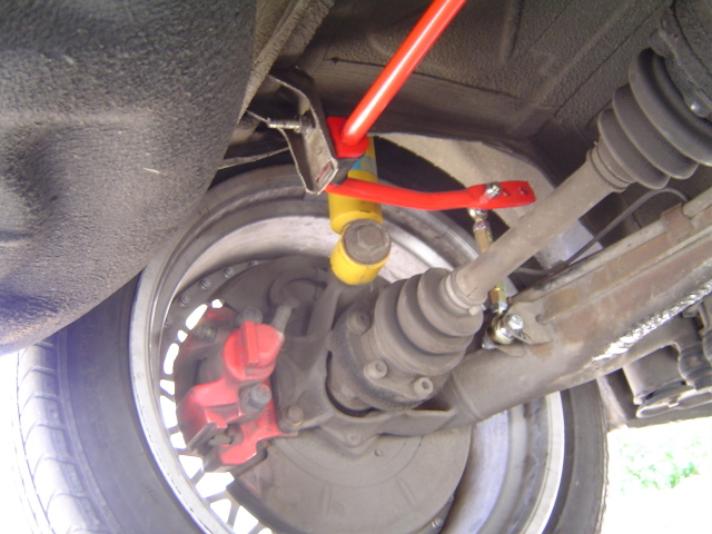

                          Are there pics of these installed? I'm trying to figure out how that mount up?
                          - Sean Hayes
                          • rs4pro3
                            • 5808
                            Yep direct replacement for stock links. I'll find some old installed pics I have for you

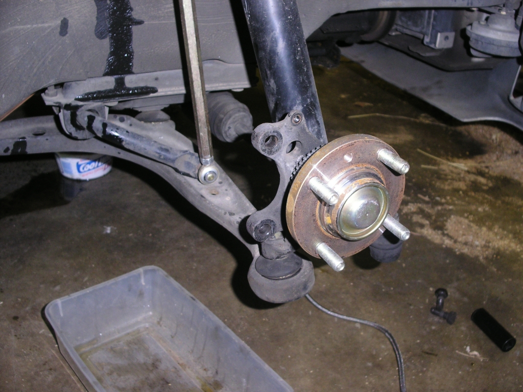

                            • rs4pro3
                              • 5808
                              Front m3 links
                              Rear links on an e28, Same mounting as the e30 ones I offer but shorter length

                                Great, so the non-m3 ones mount to the front control arm? I'd like to get in on this! Set for front and rear with stock sways. If I get the moola to you before the 8th, I'll be good?
