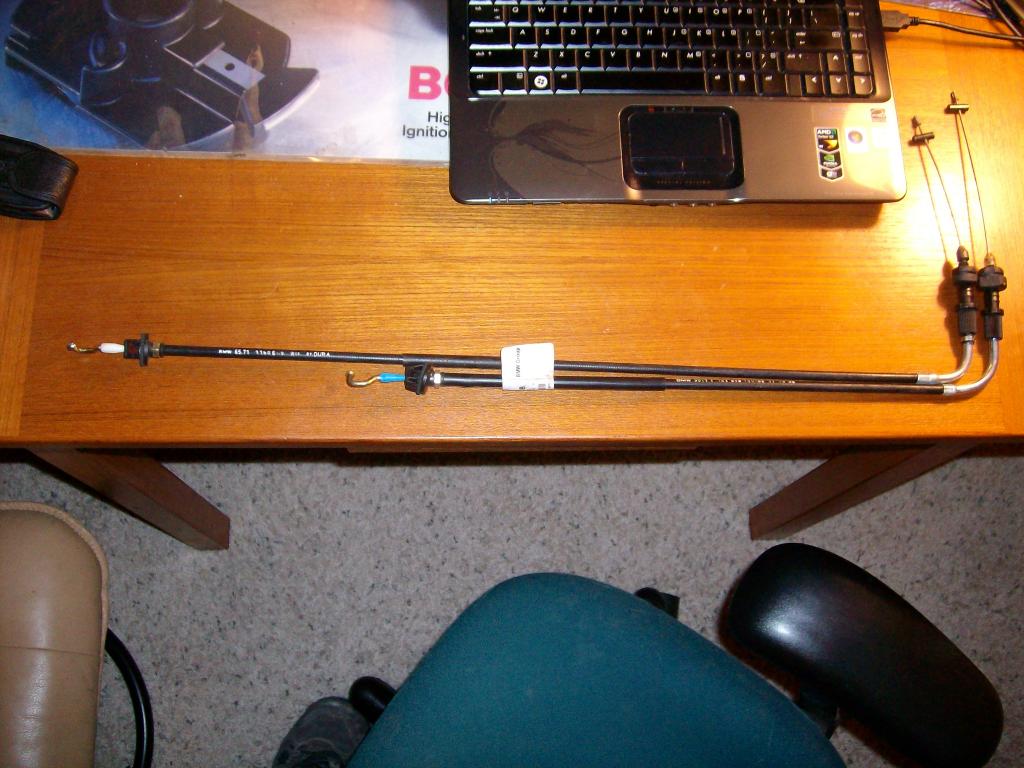

          Throttle Cable FYI:
          E34 Vs E36 Cables.
          E34 at the top.
          The E34 cable looks good cosmetically.
          The Achillies heel of the E34 cable is the length of the cable at the throttle body end of the piece.
          It is just a tad short at the TB end. Once installed, and the cable adjusted, the wire is still taut and exerting pull on the linkage. Ergo raised idle. and jumping throttle on bumpy roads.
          You can get some slack by shaving the back side of the anchor grommet by 5mm or so.
          Then it works fine.
          The E36 cable is shorter overall but has more cable exposed at the Throttle body linkage.

            Originally posted by 7pilot
            Throttle Cable FYI:
            E34 Vs E36 Cables.
            E34 at the top.
            Then it works fine.
            m

              Originally posted by JGood
              Wouldn't this depend on what the engine is from? My e34 cable works fine on my e34 m50, for example.
              The pictured cables are M50 applications and usage is for the M/S 5x in the E30, my bad.
              Your question did actually give some pause for thought, ie Perhaps instead, I could have bent the anchor bracket on the Throttle body towards the Pull linkage to shorten the distance.
                m
                What I meant was, my e34 cable works fine in my e30 with an m50 from an e34. Anyone who uses an e34 m50, will most likely keep all associated brackets, which means the e34 cable will work perfect.
