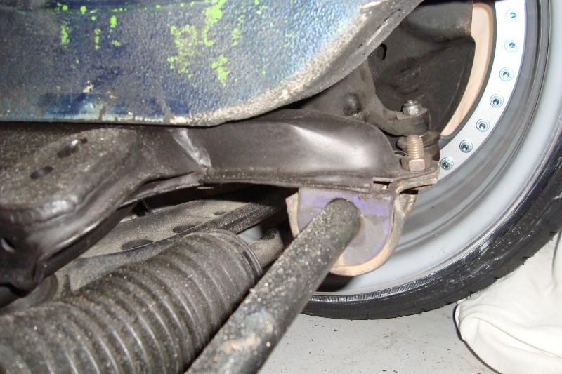

    it also has the sway bar mounts reinforced.
    Will you be able to fit a swaybar in the stock location? All of the e30s I've seen running the euro oilpan have had to switch to a swaybar mounted in front of the subframe, rather than behind it.

                          Only the rear of the pan was changed, the front was left alone. A stock S54/euro pan will not fit with this sub frame without modification. The only other modification is the sway bar needs to be relocated to the front of the sub frame and reinforced mounts will be done for this. It would look similar to this but beefier:
