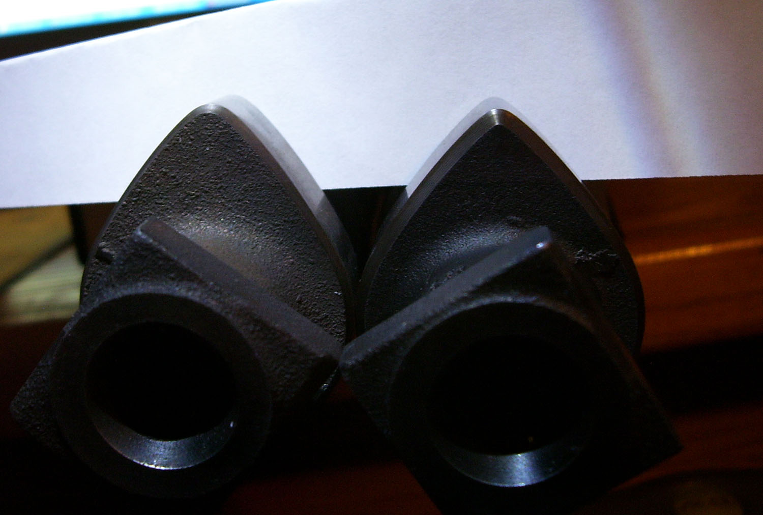

      I don't buy it. The m50 intake cam has 9mm of lift, the s50 cam has 10.2mm of lift. They are timed identically, but the duration of the s50 cam is 240 degrees vs 228 for the m50 cam. So if you have an s50 cam, the valve is not being pushed down as far, and for a shorter period of time, then it would with an s50 cam. I don't see how this would cause the car to shut off in a certain RPM range only with the vanos plugged in, and definitely don't see how it would cause the valves to touch the pistons (if they did, they'd smash into the pistons with an s50 cam, so that won't help!)
      Verify it yourself, you can see the difference visually. Look at your exhaust cam and your intake cam. They are both 240 degrees of duration on an s50, so if your exhaust cam is an s50 cam and your intake is an m50 cam, you'll be able to visually see the difference. I went through the same thing, I was sent an m50 intake cam and an s50 exhaust cam when I bought a set of "s50 cams".
      s50 left, m50 right.

              While looking for a pic to show you, I came across this thread of yours:
              If that's the cam that's in your engine still, it is an s50 cam. You can tell by the rounded points of the lobes, just as ScotcH said. Also, there is someone in that thread saying they are running an m50 intake with an s50 exhaust with no problems.
              It's your timing.
