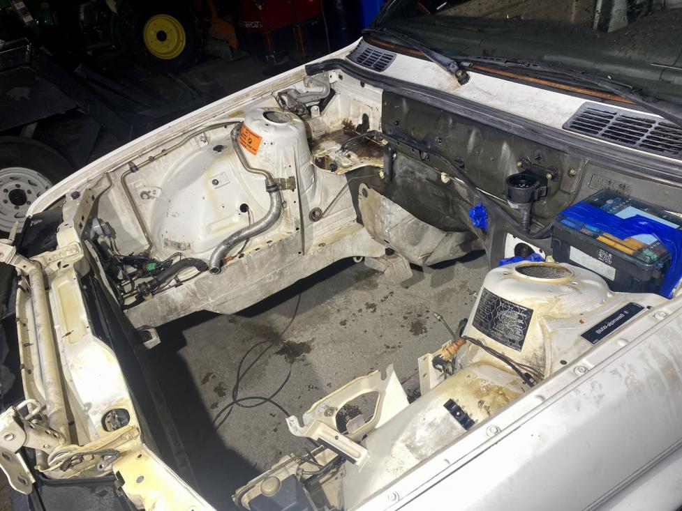

      Cleaned the engine bay up yesterday, will paint a few areas today:
