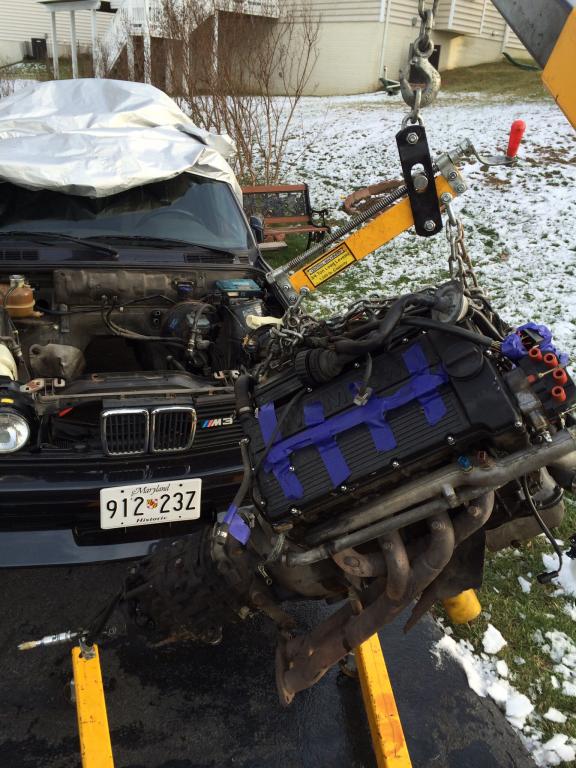

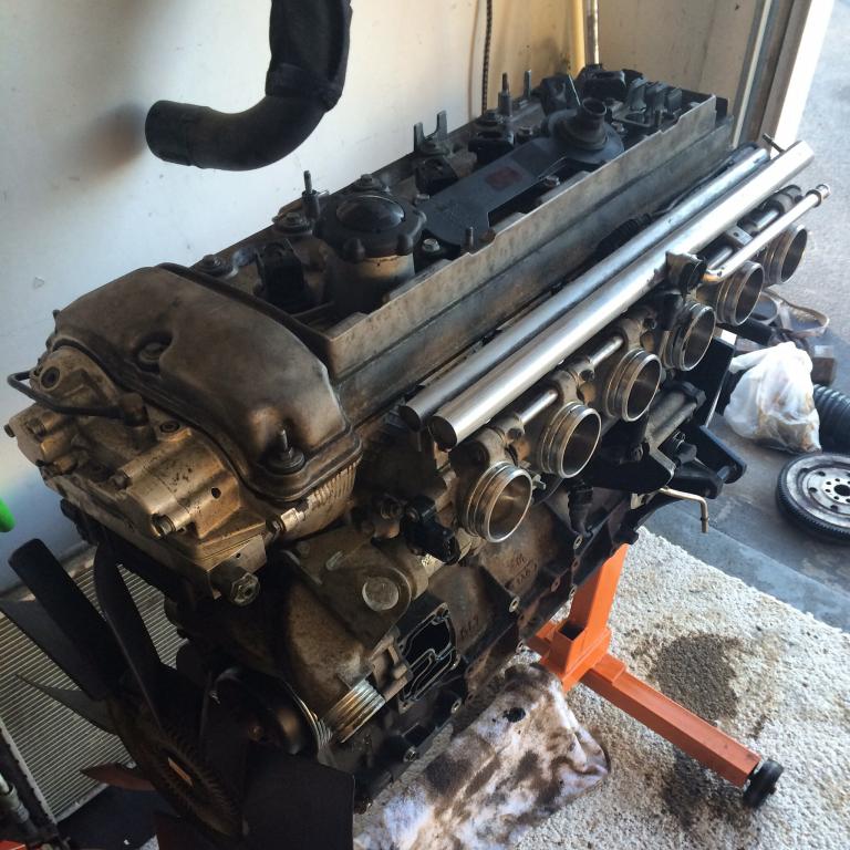

    I'm ready to start my s54 swap on my m3, the s14 is out and sold, car is on jack stands and excited about the s54. I'm currently collecting parts and so far I have..
    -02 S54 with 114K I plan on replacing the rod bearings and Vanos before motor goes in.
    -97 320zf trans/driveshalf
    -e36 engine arms
    -e32 brake booster
    -Tyler@thearcasylum swap pan and subframe
    -s54 harness/ecu plan on buying Andrews adapter and have Nando reprogram the ecu.
    -stock e46m3 rad
    -e46m3 gas pedal
    -electric fan
