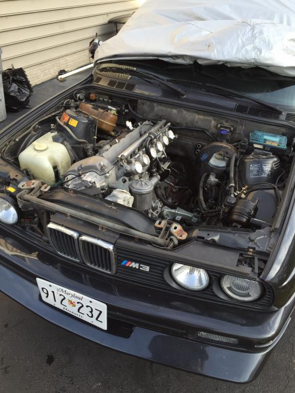

    And...motor finally in! Bolted trans and headers up to drop motor in and issue was I couldn't get the custom oil pan to clear the steering linkage, no matter much tilt or how I moved the motor around, it will not comply. So had to remove trans and headers then with some serious wiggling, it finally slid in place and without any damage.

      Wouldn't mind seeing the fitment of the subframe and sump set up from the underside.
      How close is the pan to the steering shaft?

        its like trying to fit a hammerhead shark in head first and trying to get both sides to clear and tuck under and behind the steering rack. As of now it sits nicely about an inch from subframe and clears steering shalf pretty well. I'll try to snap a pic for u.

          So you have clearance to install the transmission and headers with the motor
          In place?

            Why didn't you just disconnect the steering linkage instead of the whole transmission?

                With motor in, yes I have pretty good clearance to install trans and headers just if I had to do it over, would have just disconnected the steering knuckle instead but the freezing cold kept me from thinking straight that night.

                That booster won't clear so I'll probaly try a 735i booster if that fails then hydro boost, I definitely don't want to go booster delete. I live in Cantonsville MD but should be moving to Altanta sometime in the summer.
