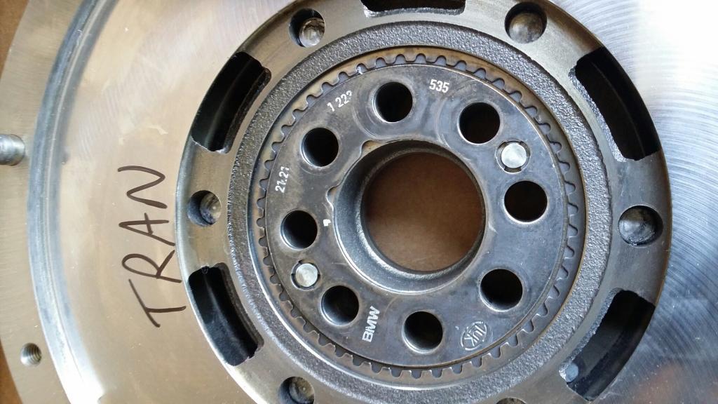

                  #38
                  My swap took a step back because I had the flywheel machined and turns out it's not an s52 flywheel, didn't bolt up to the clutch kit.

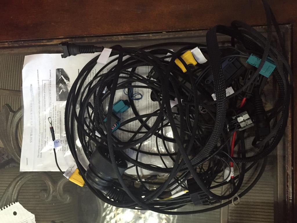

                    #39
                    Got this today, thanks Andrew :)

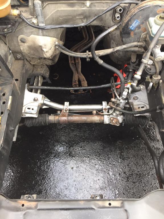

                                #45
                                ArcAsylum subframe bolted up nicely, excuse the dirty bay, my power washer broke.
