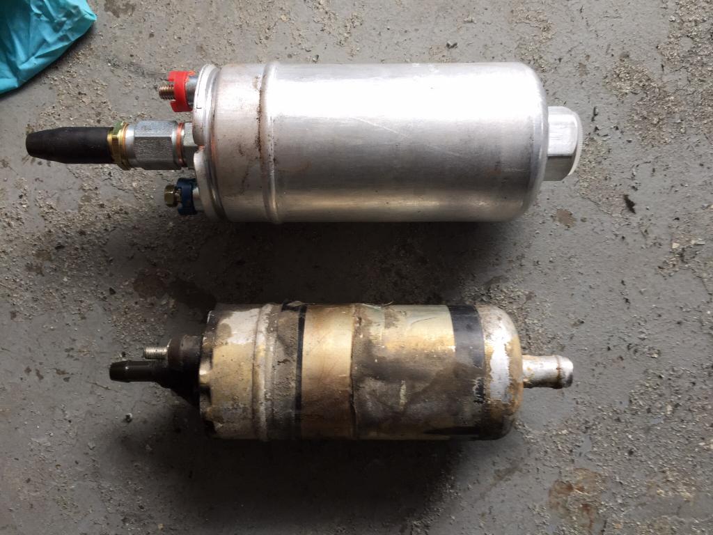

              Bosch 044 Fuel Pump Specs:
              Bosch Part Number: 0580254044
              Minimum Current: 12 Volts
              Operating Pressure: 72.5 PSI (5 Bar)
              Minimum Flow @ Outlet: 80 GPH (300 LPH)
              Fuel Pump Location: In-Line
              High Temperature Reduction: 8 GPH (30 LPH)
              Weight: 1030 Grams (2.27 Pounds)
              I will be using this and th stock intank pump for my setup.

                    Bosh004 external pump, now how to install this thing? Lol, its bigger and longer so won't fit in the stock bracket, and need to find the right fittings I guess.

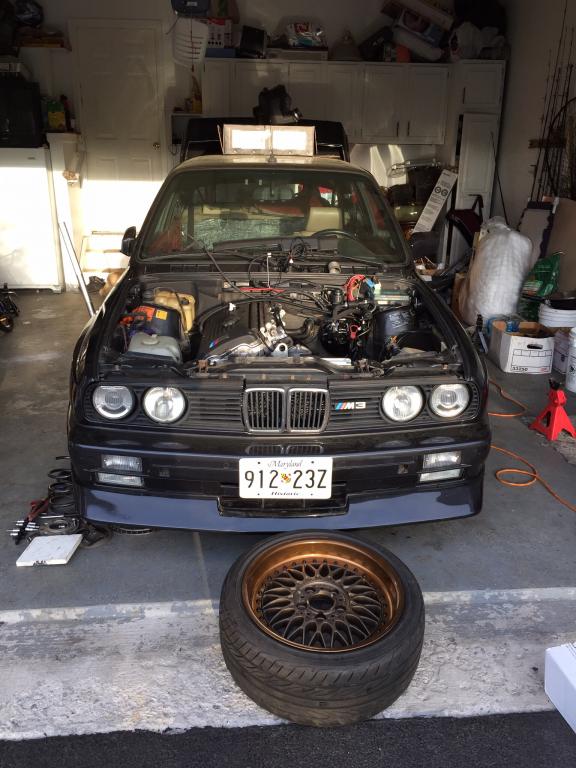

                                As for my swap progress, I been pretty busy and havnt had much time to work on it. Not much to do left tho very near to completion. I did get a chance to refinish my wheels :)
