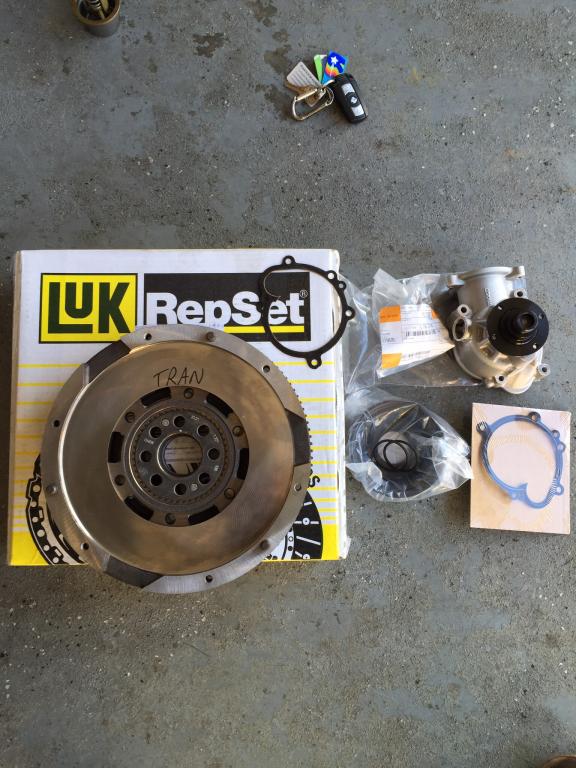

        Thanks man, and wow! those are great numbers. I've decided to go with the s52 flywheel and Luk clutch kit. Now that I have most parts sorted out I'm mainly concerned about the brake booster, I have an e32 735i booster so I'm going to see if that would fit, trying to stay away from a brake delete.
        My only diff option now is a 373lsd but gonna keep an eye out for something lower.

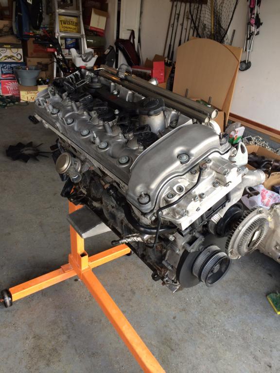

              Gave the sfiftyfour a bath today :)

                            Got some goodies today, a step closer towards the finish line.
