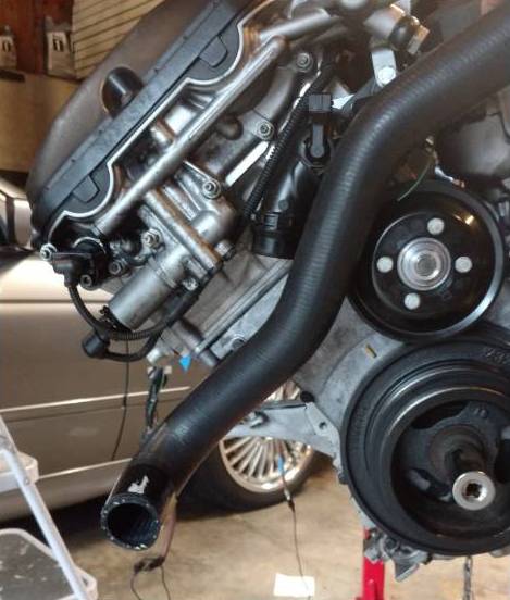

                I'm still looking for a good solution to the lower hose. The best I could find on my current swap has a slight kink. According to DesertBMW:
                Radiator hoses. Use gates 21900, then cut to fit, you get lower and upper hose. Use the quick connects from the E46 thermostat hoses, then cut the clamps and remove the E46 hose from them.
                Edit: this is what the hose looks like. Looks very promising! The original application is for a Toyota Previa.
                Ill try that soon and report back by editing this post.
                      This is the one thing I'm really curious about. Once we get the radiator hoses figured out 100% then its just plug and play!
