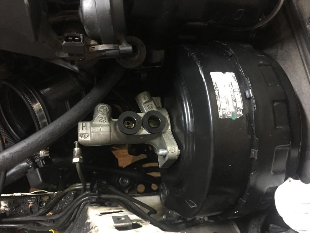

                                #75
                                E90 Booster
                                So I was able to install the e90 booster. It was a tight fit getting it in. I needed to move the fuse box over, remove DISA, and lift that side of the engine up an inch or so to get it in. Fits like a glove. The reservoir will interfere with the DISA, so I am looking into solutions....could do remote, modify existing reservoir, or find something that will fit. Since the E90 Mcylinder has the outlets on the wrong side, I ordered a used X3 MC that has the right side outlets, and is looking like the existing lines might even fit with a little persuasion.
                                So far, seems like one of the better solutions, as the parts can be found cheaply on ebay, and the booster should have better capacity than the VW/944/2002 ones.
