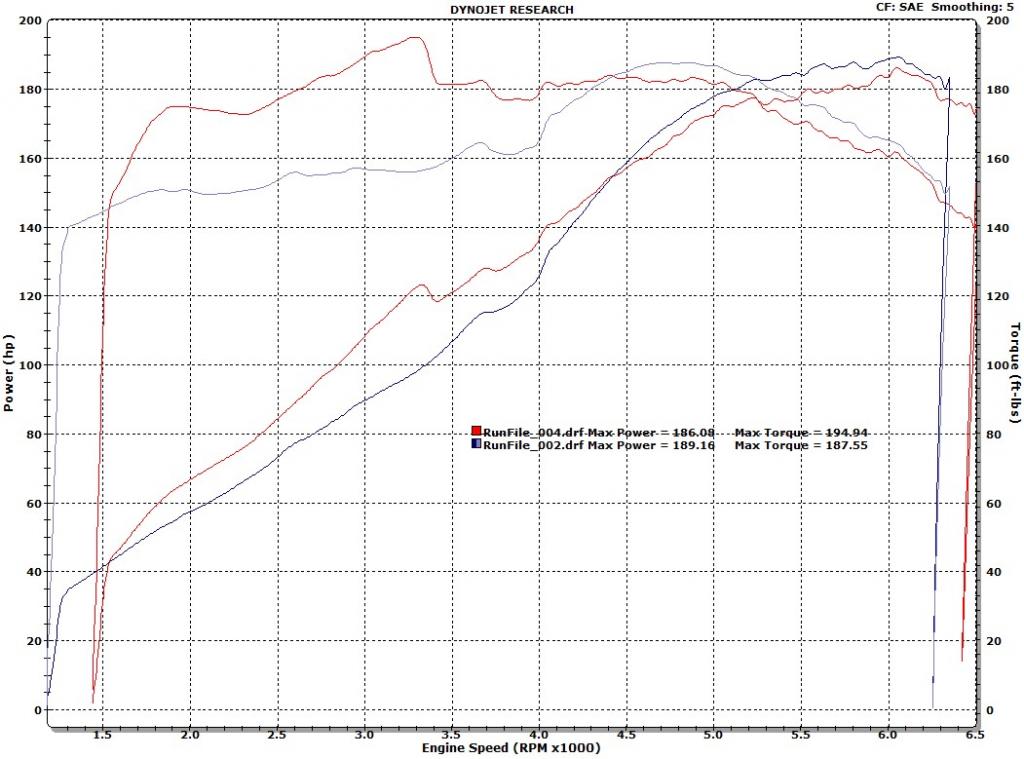

                      Attached is the plot of two runs, the first without any electronic magic, no DISA, no variable anything. All motor. Kinda weak down low but it does fine for peak power.
                      The second plot has variable intake timing and DISA. Intake peaks at +20 degrees advance at 2000 rpm and then slowly tapers down to nothing by 5700 rpm. Torque continues to build to a peak at 3300 rpm where the DISA switches to the short runners and then drops and never really recovers. Max difference is an additional 40 ft-lbs and 25 hp at 3300 rpm!
                      I can be a little more aggressive on intake advance, probably holding it to max until 3500 before reducing it. DISA also works extremely well and I will hold that in resonance until 4000 rpm from now on. I'm amazed at how much it drops when it switches. I can't explain the difference in peak power between the two, because the cams and DISA are the same after around 5500 rpm,
                      Max wheel horsepower of 190 here equates pretty well to M54 rated power of 225-230hp at 5900 rpm. I'm working on a TRM chip, I'll physically advance my timing on both cams by around 5 degrees and upgrade the e36 muffler. Retarding the exhaust cam 12 degrees lost me around 16hp across the board, so those changes should come close to netting me 250.

                          got a plot of a stock M54 with stock electronics for comparison?

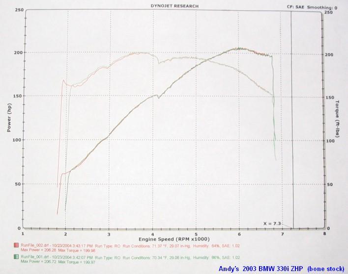

                            Good point.. here's a stock 330 with ZHP cams which is supposed to have at least 10 more HP. Both on Dynojets so it's a good comparison. Some interesting parallels going on... looks like I have better low end torque.
