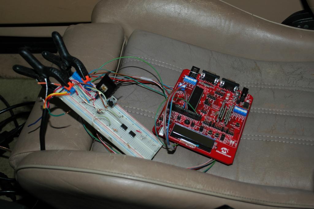

                        #146
                        Closed loop!
                        I've been working on little sections of the VANOS controller at a time. First, identify the missing tooth and count the teeth to maintain crank angle. Add in the cam shaft trigger and read camshaft phase. Add basic PWM output and see how the cam reacts to different signals. Next, add a PID function to try to make the cam match a command position.
                        It's been one obstacle after another, the latest being the PWM solenoid switching inducing noise into my cam signal, throwing the board off.
                        So I finally got all that working and am able to move the cam to intermediate positions. Hurray for me!
                        It's a lot like balancing an upside-down pendulum, the cam really likes being at one extreme or another.
                        I have more PID tuning left and then I will start making an RPM-throttle position-cam advance map. I also need to see how it reacts at different RPMs and oil pressures.
                        Some of the issues I will need to overcome include, How to I give the 413 a "vote" in positioning the cam? I can't completely usurp its will because it switches maps internally. Plus, I've found that standard VANOS isn't even on that often. Not on when the motor is cold, at very low RPM's, high RPM's, low throttle settings or anytime you are decelerating (low throttle setting).
                        It's only on when you mash the pedal on a warm motor.
                        Maybe in another month I will have a mapped controller with the 413 controlling my MOSFET drivers.

                              #149
                              What kind of education/work experience do you have in electrical stuff? You're going nuts on this thing and seem to know exactly what you're doing. Very impressive, I wouldn't touch it with a 20ft pole.
                              I have a Smorgasboard of experience, I'm drawing on lots of different things I've learned over the years to get this done.
                              -I learned how to program Z-80 processors in assembly language as a kid. Remember the TRS-80 computers? I'm doing this controller in C++ but it's the same idea.
                              - My BS is in Systems Engineering which is all about the theoretical side of control systems. I also taught that for 2 years. Feedback, Error, Stability, etc. Sound familiar?
                              - MS in ITM (Information Technology Management). More computer stuff and LOTS of signal analysis, FFT and such.
                              - My mechanical background comes from being German. Is that stereotyping?
                              - I flew helicopters for 15 years. I expect things to work but plan for them to break.
                              - I have a P.E. in EE which is where I learned a some other useful tricks.
                              - I have the Google machine!
                              Put it all together and I'm comfortable doing this. My weakness will be in the theoretical and practical side of exactly when to advance/retard the cams for best performance and tuning.
                              Currently I have the closed-loop control working marginally well. I've increased the gains to get faster response but that's given me some overshoot and hunting. I'm hoping that more tuning of the parameters will smooth that out. I have a little potentiometer that I can turn back and forth to adjust the cam. It's my "dial-an-advance". :grin:
