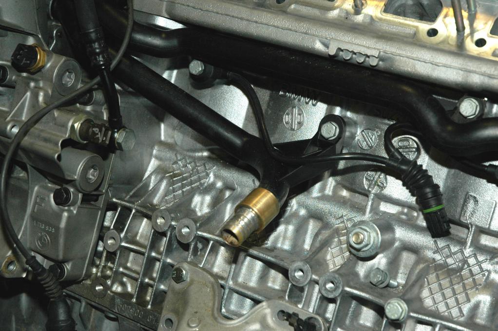

      I still haven't found a home for my e30 cluster temp sender. There's no obvious place to put it.
      The picture is the water return pipe. The one on top goes to the heater core and the one with the brass adapter comes from the core and the expansion tank. I cut about 8" off that pipe because it originally went down to where the PS resevoir is. This will allow me to keep an e36 PS resevoir which will let me keep an e36 alternator. The Turner adapter won't fit in the M54 block, so I epoxied a brass adapter on the pipe. The pipe has almost exactly a 1"OD which made this really easy!

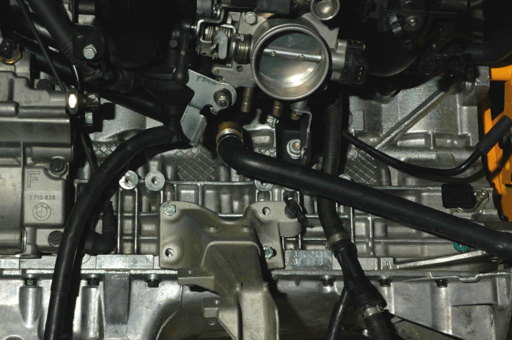

        Heater hose
        I went to Napa auto parts and got a generic molded heater hose with a 90 degree bend to go on my newly grafted fitting. The hose will get a "T" fitting at the appropriate place when I get the motor in the chassis for the coolant resevoir.
        I put the manifold back on and am really pleased with how well the pipe modification came out. In addition to greatly simplifying the plumbing it also gets the pipe out of the way of the throttle mechanism, which was a problem before.

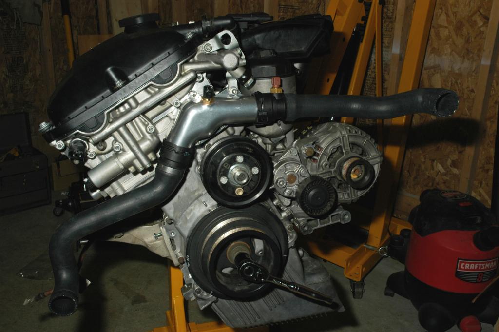

            FedEx also delivers today which means I got the last pieces of my cooling system puzzle in. I had previously ordered e36 radiator hoses but still didn't have a way to connect them to the new-style modular connection on my Bling! thermostat housing. I've been planning on scrapping some M54 hoses to salvage the plastic connectors but since I didn't find a place to mount the e30 temp sender I had to re-think everything.
            My final piece is the lower M54 hose which has the two plastic snap connectors, but the one that goes to the radiator also has a bung for mounting a temperature sensor. On the M54, this measures radiator outlet temp and is used to trigger the variable speed electric fan.
            For me, I've moved it to the outlet of the thermostat and it's where my e30 gauge sender will find a home. The bung was the perfect size for an M14 tap and the sender screws right in. It's not the perfect solution, but I'll be measuring water temp close to engine temp once the thermostat opens.
            I'm not sure why they added a temperature sensor to the thermostat housing, but it also measures inlet water temp. I'll probably plug that hole.
            I've cut a few inches off the top e36 hose to compensate for the plastic piece and I may need to trim another 1" off. Better to do that in the car.
            The lower hose is completely stock M54 with the radiator connector removed. I found that the e36 hose would NOT work because the angle of the thermostat housing is changed to clear the exhaust VANOS solenoid.
            Notice the lack of a crank position sensor mount and toothed wheel. I don't even think there's room for one with the revised hose routing. Unfortunately, the A/C pulley is part of the vibration damper and can't be removed seperately. Will I need to remove the whole thing to clear the motor on install?? Maybe.

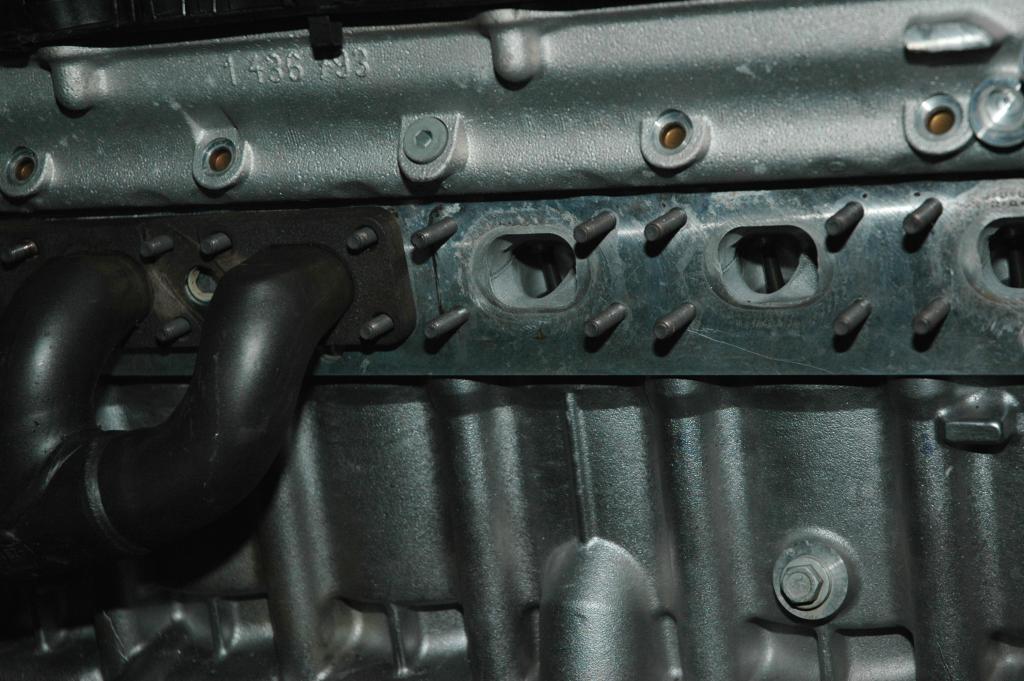

                    No suprises here. The OBD2 manifolds bolt right up. The exhaust ports have more of a square shape than I remember on the M50 or is that my imagination? One thing I learned from my last swap is to not tighten the manifold nuts down until the downpipe flanges are mated. Those were a b!tch to line up last time.
                    The air injection port on the M54 head is blocked and the manifold ports are welded.
                    Did I mention the engine is aluminum? It's super-duper light. I'll use the engine hoist to pull the M50 out but will probably just lift the M54 in by hand...

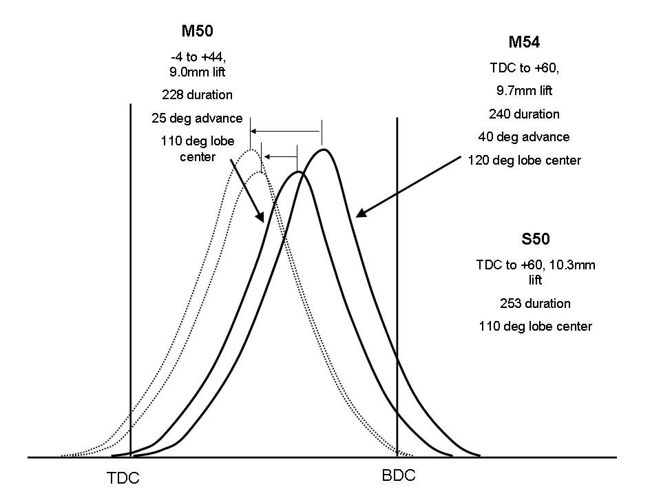

                              Cams
                              So I will probably pull the M50 this Saturday...
                              I'm looking at different cam specs and I know that the M54 is 240 degrees duration intake, 244 exhaust with lifts of 9.7 and 9 mm respectively.
                              The S50 has 253/10.3mm intake and 244/9.7 exhaust.
                              So the M54 has 12 degrees more duration on the intake cam. My question is, how does the math work with VANOS advance... If the M54 VANOS advances 15 more degrees than the M50 (40 vice 25), but has 12 degrees more duration, does that mean it works out to be about the same??
                              One of you really smart guys must know the answer.
                              .....edit.....
                              I drew myself a picture and I think this is what it works out to. The M54 is initially a little more retarded on the intake and ends up advancing just past where an M50 does.
                              I am not a cam expert. Anyone have some insight on this?

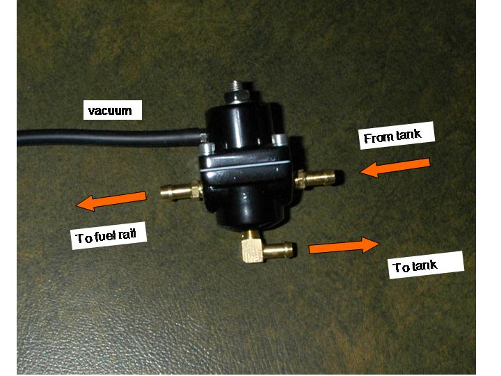

                                Fuel pressure regulator
                                It's a little thing, but still important.
                                I need to convert the return fuel system to a non-return fuel rail. For the sake of emissions (again!) the fuel rail was changed to not flow the fuel through it. This was done to keep from heating it which reduces vapor pressure and evaporation.
                                Anyway, the fuel rail is a literal dead end and I need to add an external fuel pressure regulator that will shunt the proper pressure to the rail.
                                I have a fuel pressure gauge on the rail that I'll calibrate it with once the motor is in.
