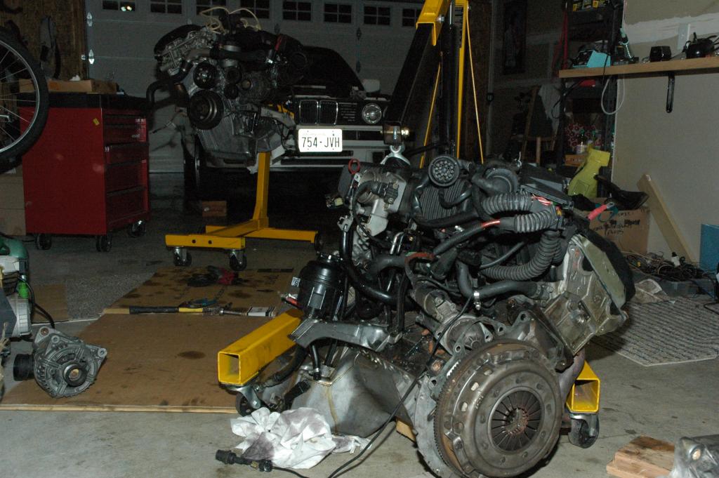

            #95
            Out with the old...
            I really didn't mean to take it out tonight. I was just going to disconnect a few things. Then I started fooling around some more and one thing led to another. It just slipped out. I swear.
            I learned in the process that the M50 power steering pump IS NOT compatible with the M54. The pulley ends up being offset by about 5/8". I need to order an M54 power steering pump ASAP.
            However, the M50 alternator DOES fit. Good thing, too. As an 80amp alternator it weights about 6lbs less than the M54 120amp unit.
            I'll mate the flywheel,clutch and tranny tomorrow and probably have it back in the car.
            I bought the house for the garage. ha ha!
            Oh yeah, I'm riding my bike to work tomorow.

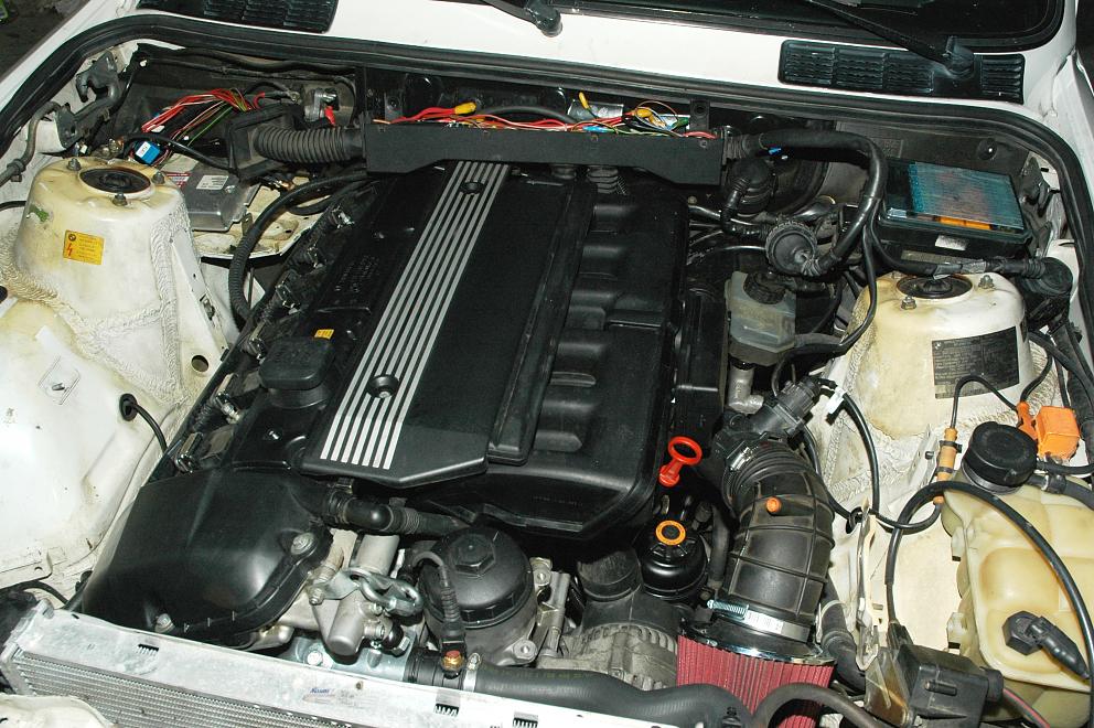

                      #100
                      ...in with the new
                      e30 M54 OBD1 is now reality.
                      Motor went in last night and after the 3 connections needed to start it fired up almost immediately. It fell into a nice idle and I shut it down for the night to connect radiator, driveshaft, etc.
                      This morning with a newly filled cooling system I let it idle and had puddles of coolant. One leak was from the heater inlet connection and a really elusive one was a small plug on the back of the head. My guess is the machine shop used that when they pressure tested it and didn't tighten it all the way.
                      So, took it for the first drive around the 'hood and had a bad shudder at around 3500 rpm. Check engine light came one. Engine temp gauge not working. ABS light illuminated. Hey! at least it was driving.
                      The shudder was from low fuel pressure. I only roughly calibrated the regulator when I installed it and found it only had 30 psi. 50 psi fixed the shudder completely.
                      Still need to connect the Oxy sensor, it's running open loop. The e34 connector is too short! ABS is from lack of power. Easy fix. Check light is probably from the oxy sensor and maybe from the ECU detecting too much advance.
                      The temp gauge either isn't getting hot enough at the thermostat outlet or my wiring is jacked.
                      It has the Power Steering bypassed which really isn't that bad. I also have tons of room next to the brake booster and could go back to stock if I wanted.
                      It pulls strong off idle and is flatish between 3-4500 rpm. REALLY strong at 5500. So far my M50 is still the better motor. I would rather have a really well tuned 2.5litre than a tempermental 3.0 any day.
                      At this point, I need to finsih the Oxy sensor at a minimum and drive it some more. I am encouraged that the Hall to VR circuit is working well and that my Timeserts and head straightening appear to have been successful.
                      I'll turn my attention to a simple open-loop VANOS controller that will electronically govern the full retard and advance ends of the range to more closely match M50.
                      I will also control the DISA valve with a simple shift light circuit.
                      Lots of room for improvement at this point.

                            #103
                            Dinan!
                            Never mind some of the stuff I send in the previous post. I wired up the O2 sensor and replaced the stock M50 chip with a Dinan S50 chip (Thanks DougsIC!).
                            Wow!
                            I need to get the smell of burning rubber out of my car now. I'm beginning to like.
