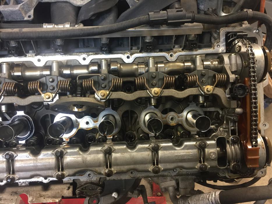

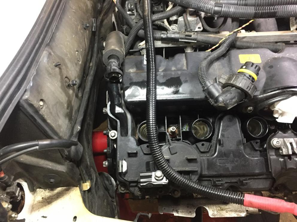

                              So I got a hold of a really nice 45k N52 very inexpensively. Popping the valve cover confirms its age, so hopefully its all good!
                              I put on the Z4 engine mount arms, but they do not place the engine well. Engine is about 2" too far forward, and also a bit too high. Probably have to make something custom. In a way, this is a good development, as the Arc Asylum subframe placement was requiring a couple inches of the oil pan to be removed. By being able to go back 2", it might eliminate/reduce oil pan modification, and more importantly, having to fab an oil pickup tube. Will see as this progresses. Brake Booster will be tight, and is another one that will become clearer in time, but I can always go to an N54 intake manifold, which should allow most boosters to fit.
                              Stay tuned.
