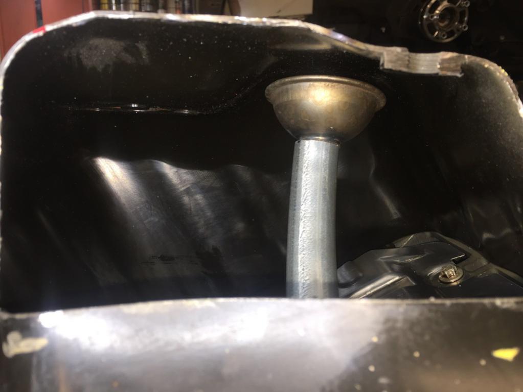

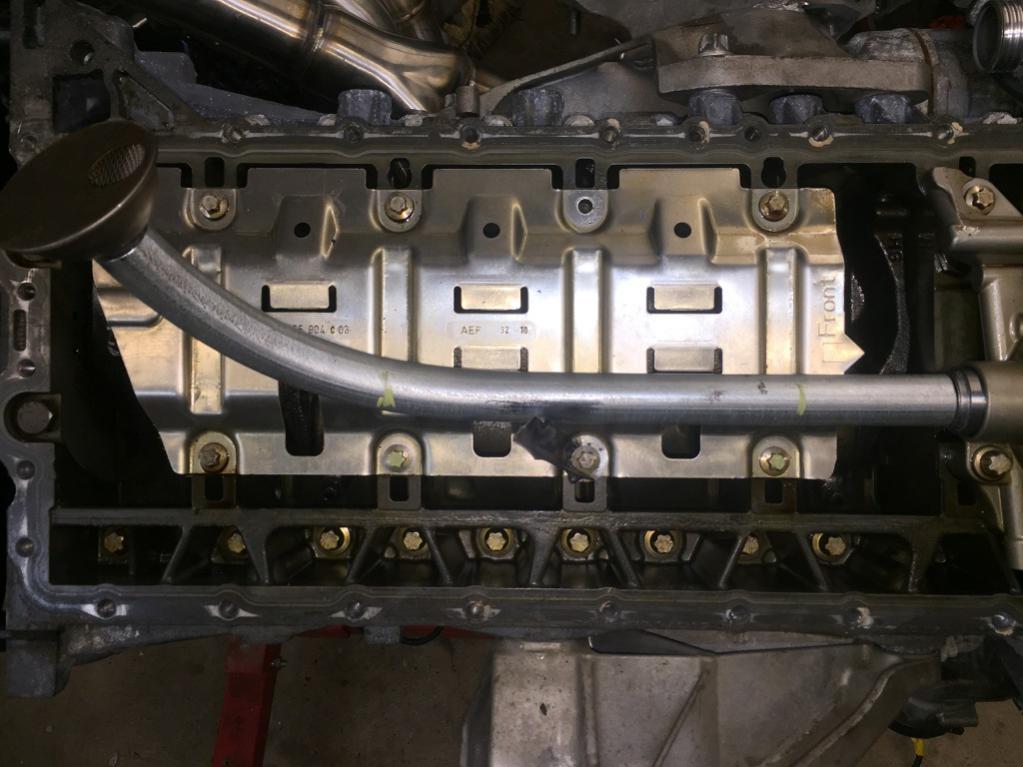

      Thanks Will. I considered that option, but decided to go this route instead because of 2 issues. 1. It will limit any flexibility in the sump inlet location without messing with the plastic mounts. 2. A 2nd o-ring and added leakage possibility.
      I will fasten the plastic tube to the rear bolts and see where the outlet ends up exactly. Maybe the location will work. I seem to remember it might have impinged on the oil level sensor, but I never did check.
      So, instead, here is a rough model with what I have come up with. After looking at the machined piece w/o-ring, I concluded my concerns with weight and potential o-ring damage were overblown. I'll probably use the 3/4 emt as well. So 3/4 emt, bent and cut to fit, welded M54 inlet end, and the other end will have the machined end w/o-ring. I will have 2 mounts welded to tube (Yellow marks), and fastened to block. Should work well.

          That looks great! Can you make more of those adapter peices?
          On mine, I need to squish the tube down a little bit where it crosses the front axle, which is one reason the plastic one just won't work.
          As far as your concerns about the O-ring leaking - remember, this isn't under pressure, it's sucking oil up from the pan. And even if it did leak (which it probably does anyway), it's just going to leak to/from the inside of the pan. Imagine how many people replace that O-ring over the life of the engine - probably nobody - and I know of many of these with well over 250k.

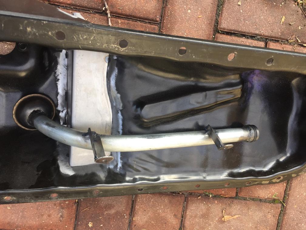

                  So the pickup tube is complete, I have fitted the oil pan patch and tacked in, and so next step is to put engine back in car. After doing a final check on the oil pan clearance, I will then tig weld it complete, paint, and move onwards to assembly of the rest of the engine, and wiring.

                    looks great - man I wish the ix used a steel oil pan, that looks so much simpler to modify!
