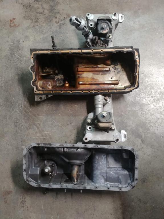

          Although the arc asylum subframe uses a bent tube to move the center section forward a bit, it still requires the oil sump on any s54, m54, or n52 to be modified. Any more forward and the steering rack is in the way. Now if you put the center tube in front of the rack, it might be enough room to not have to modify the sump. Would be close.

                  Im currently out of town, but will check clearances. I think i took about 1 1/2" off oil pan. If the firewall could be clearanced that amount without hvac work, it might be a good option. Driveshaft and shifter linkage already require modification, so that is not a problem.

                    heh, lately I've been having the crazy thought of not installing the AWD (for now) so I can get this damn thing running - I haven't mocked it up yet but the RWD N52 pan might fit just fine with the ix subframe. :|

                      yeah, it clears the ix subframe by a country frickn' mile. I think there's even plenty of room to finally do the E46 xi rack.
                      A RWD ix is blasphemous, I know - but I just don't have the time/energy/resources to dick around with the oil pan, and I could finish the engine with what I need to spend on rebuilding my CV shafts. I would probably make it AWD again later, but it's not like I drive it in the snow anymore anyway.

                              Wow, that ix subframe sure does leave plenty of room. Engine mounts will be the next hurdle with that setup.
