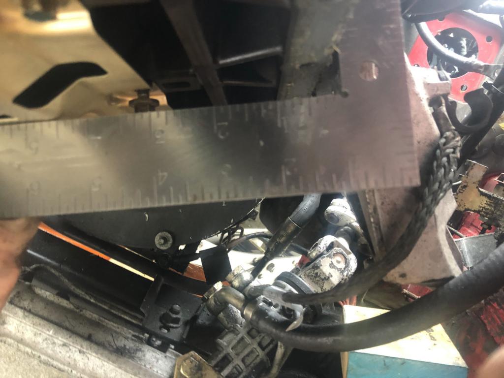

                With everything in position like this, the hood *does* shut, but the engine's obviously going to have to go down. I had to take out the felt liner to check against the skin. The valve cover has maybe 3/8" clear, and the oil filter housing is pretty much touching. With only that much clearance, here's where the block sits relative to the steering rack:

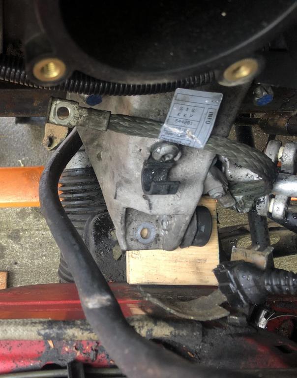

                You can just about see the radius I cut into the pan fixture there. I think I'm going to have to lift the engine, take a bigger chunk of that angle out for room to work, and find something thinner than the 2x4's to shim up from the factory motor mount locations on the subframe. I don't think I'm going to be able to get much... maybe 3/4" further down. I'm not worried about having room *for* a motor mount, because once the block is in the right place there's plenty of room for them when the new arms are built. I wish there was a little more room vertically.
                This probably doesn't look like a lot of progress, but there was a lot of head scratching and wiggling and measuring.

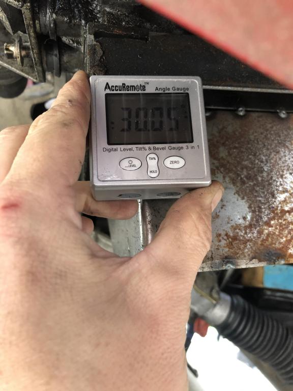

                  No one's going to believe it, but this is what my gauge showed for the pan angle relative to the flat spot in the center of the radiator core. Assuming this block is 30 deg like the m5x's I think as long as my shims are the same height both sides I'm going to be ok for rotation:

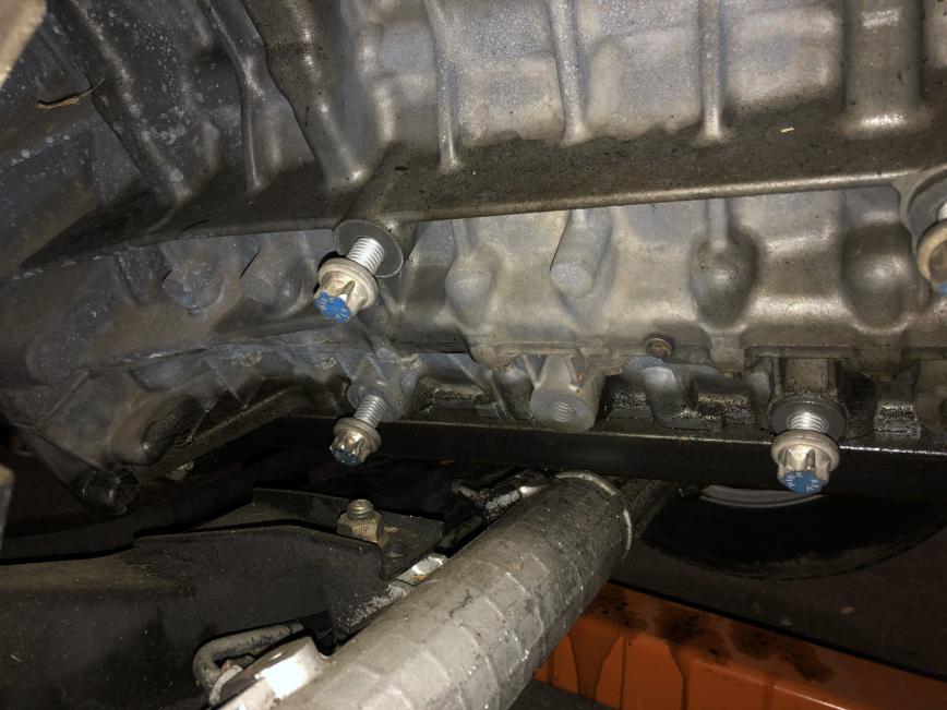

                  I was really only checking that dimension so that I could justify the size of the chunk I took out of the pan fixture.I really only need room for a flange and bolt down here. One of the bolts is visible with the angle cut away. You can see the low point is now the sharp corner of my "pan" section... That doesn't need to come off the flange at 90, and it's probably not a great idea for the lowest point to be a corner against the mid span of the steering rack *anyway*, so if I want to I can touch here and still make clearance later.

                  I'm not really waiting on parts or anything... my next task is re-orienting the engine using the new clearance and making a template for the transmission mount (that's going to be built before I fix the pan fixture in place). However, it's wet outside... so I moved on to digitizing the pan gasket to build an oil pan flange template. If I'm going to get any of this stuff cut, it's a waste to not fit pieces "inside" the pan flange...

                    yes the N52 is the same angle as the M50.
                    AutoCAD! Are you going to make a flange or something?

                      That’s my only hope to get a pan built... the flange has to match the gasket, so I’ll have to get at least that laser cut.
                      The hope is to document everything I have to build so I can re-order a “kit” for the next fool.
