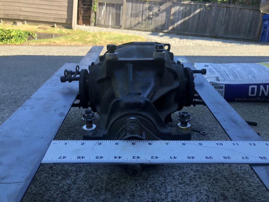

        Ok. hoveringuy and I spent about two hours shouting at each other through masks in my driveway this morning about drivelines, engine position, and wiring. I learned a ton. I went back out just now to confirm some things in the dark. Best time to make these kind of observations.
        First of all, the driveline is not centered down the car. It's more complicated than that. Since we were looking at a car with a missing motor (or at least not a factory motor) we started from the diff. I pulled my spare out from the back of the garage and we were already slapping our foreheads:

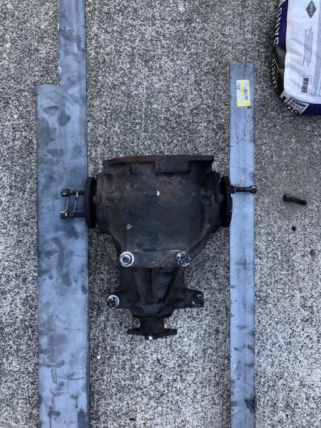

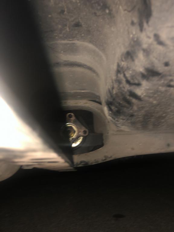

        The pinion yoke is NOT centered between the output flanges of the diff. The casting is very obviously not symmetrical (I would have put money on this from memory if you'd asked me). The yoke is very, very obviously off to the starboard side of the diff... just look at the relationship between the front two diff mount bolts and the input. The output shafts are the same part number, and there's no difference in the hub thickness between left and right... The diff output flanges are centered on the car, and the input is off to one side. How much?
        Something metric, but it's about 5/8".

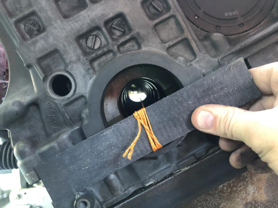

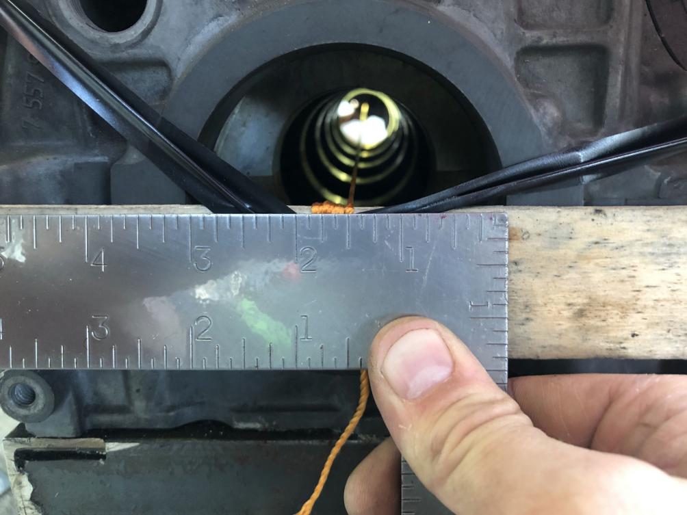

        I centered the engine using the 330i engine arms against the frame rails, and checked it against the ball joints. The centerline of the engine is correct. I centered the shifter in the tunnel opening, and had the shift carrier in the bushing when I locked down the engine position, so rotation in the vertical axis was correct. the lean angle of the engine was checked against a few parts of the car that looked "level" and I'm within a 10th of a degree. Engine and transmission height were guessed... for sure... but that doesn't mater for now. The question is... is the engine pointed at the diff, and if not, why not. We looked at the complete engine/trans and convinced ourselves that the input and output of the transmission were probably aligned (the output is at least aligned with the casting joint, which looks as much like the CL of the trans as it can be.) So crank center can stand in for trans output center. We centered a stringline at the front main seal:

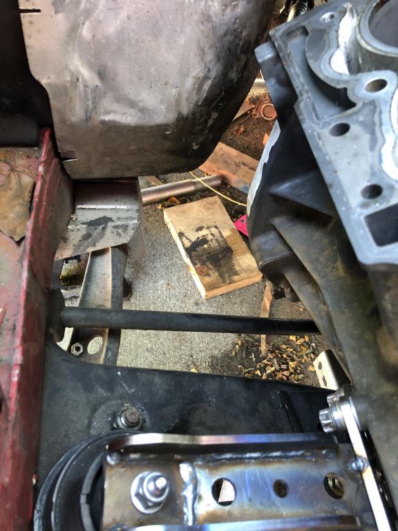

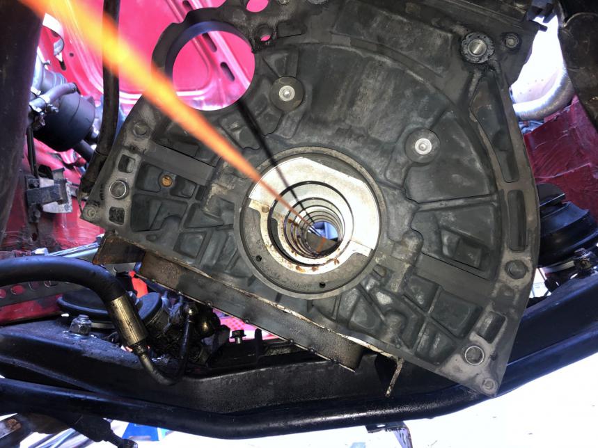

        And then one of us pulled it tight against the rear subframe while the other shouted directions until it was centered in the rear main seal:
        Guess where it ended up?

          #244

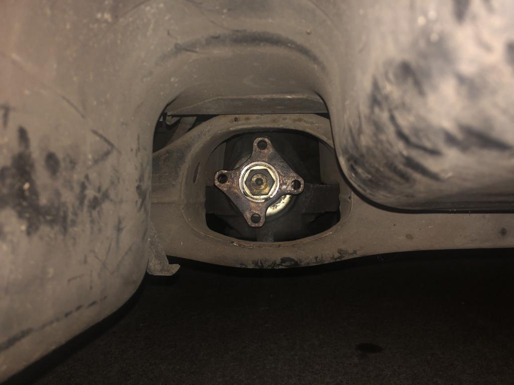

          It ended up here...

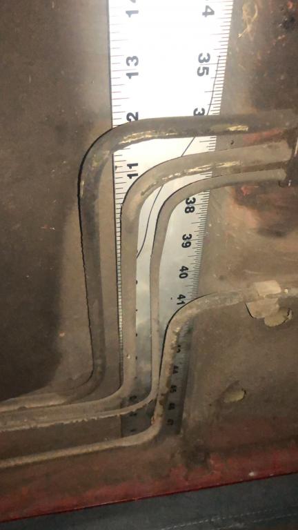

          Not even close to the middle of the diff. Not *exactly* 5/8"... about another 1/4" to the port side (right in this photo). But damn close to the centerline of the car according to our diff output flange measurement.
          So what. Is going. on. Maybe everyone else on this forum already knows this. I couldn't figure out what was going on. I went back out in the dark just now to try and figure out what was centered and what wasn't. The pictures aren't great, but I have two long aluminum straight edges that I think are for drywall. One has a pinned 90 degree tee. There's a rib that looks like it must be perpendicular to centerline right where the fuel lines turn, and I could measure the inside-to-inside between the pinch welds at the sills along this ridge. The straight edge is held against it on the left here:
          I took the centerline of the car and set my 90 deg square against the edge above, and again this is hard to see:
          I know this is a terrible photo, and the shadow makes it worse, but the visible edge of the tee is dead center on the ovoid in the crossmember, but the diff is offset to starboard (left in the photo). The opening in the subframe is centered, and the pinion yoke is very obviously offset:

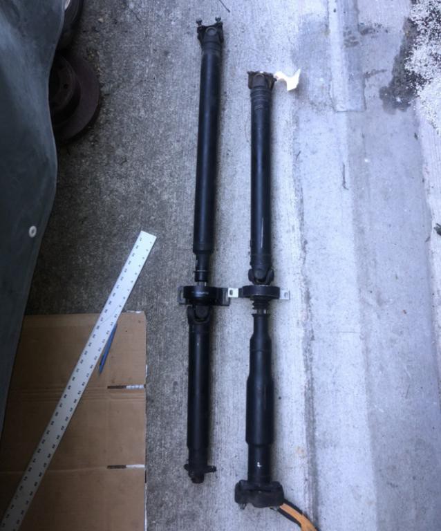

          This is an old photo of the E30 drive shaft (left) and Z4 drive shaft (right):
          I haven't been able to figure out to this point why a driveshaft from a motor and transmission mounted to the frame, to a CSB mounted to the frame, to a diff mounted to the frame, needs U joints.... and if they do need u Joints, why doesn't the front section need u joints between where the trans output is to the CSB? The engine is the big heavy moving thing at the front, and it seems like the lever arm with the hard point at the CSB would just reef on it every time it moved.
          The reason for the U joints is that from the CSB to the diff, there's a horizontal offset. The diff pinion and crank are parallel, but not concentric. The U joints are there in the back half of the shaft to allow the shaft to deviate to one side (something around 5/8") so the diff can be centered. The E30 joint arrangement is notoriously difficult to align because one of the joints is in front of the CSB. I'll be using the Z4 assembly order, but with the correct E30 CSB carrier (not flipped... in the correct location). If I can't get this aligned at the transmission output with shims, I'll modify it. I'll check to make sure that the pinion yoke and trans output are parallel (and adjust that with the transmission mount) so that the u joints have equal angles.

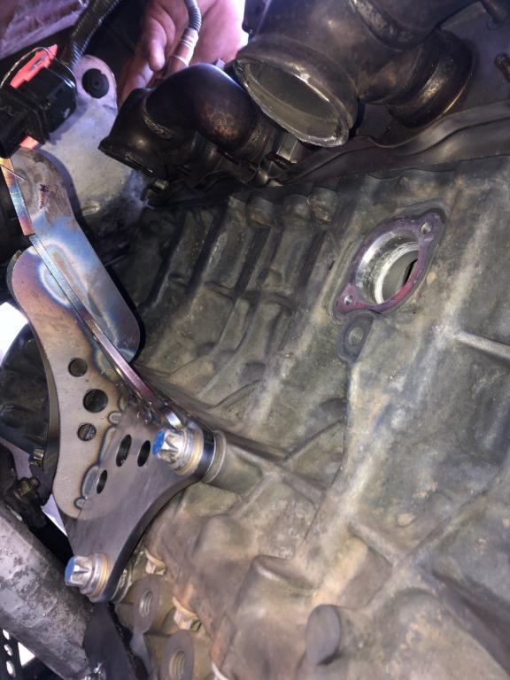

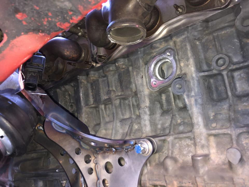

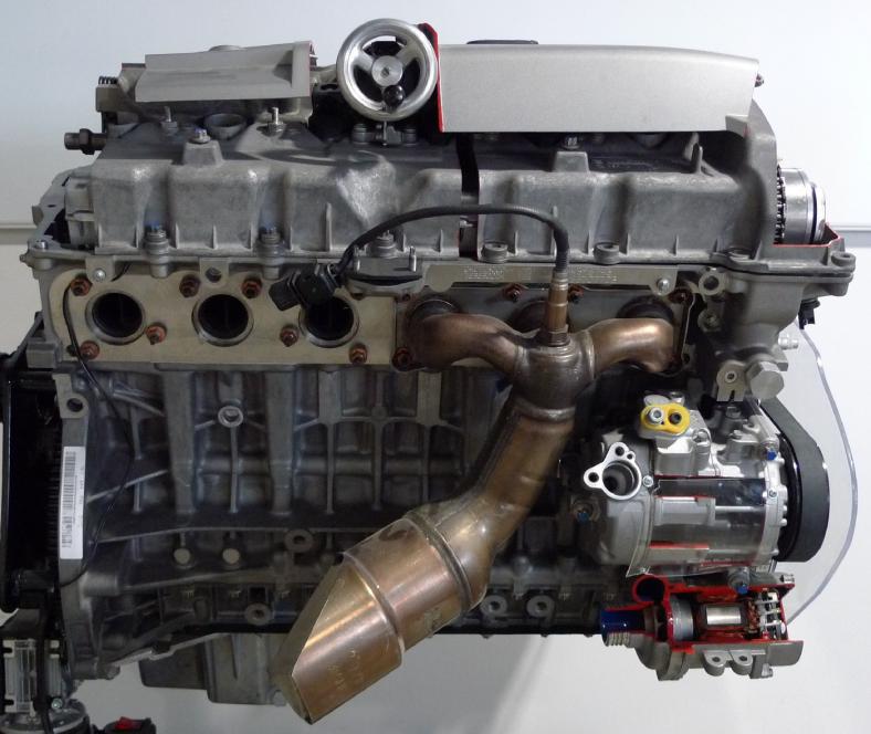

            Someone PM'd me with a fear about exhaust manifold clearance. There's a huge weird schwoop shape in the factory starboard side engine arm that I didn't re-create. It's to clear these cats:
            If you aren't running the cats, there's a ton of room to turn a little higher and clear the fabricated arm:

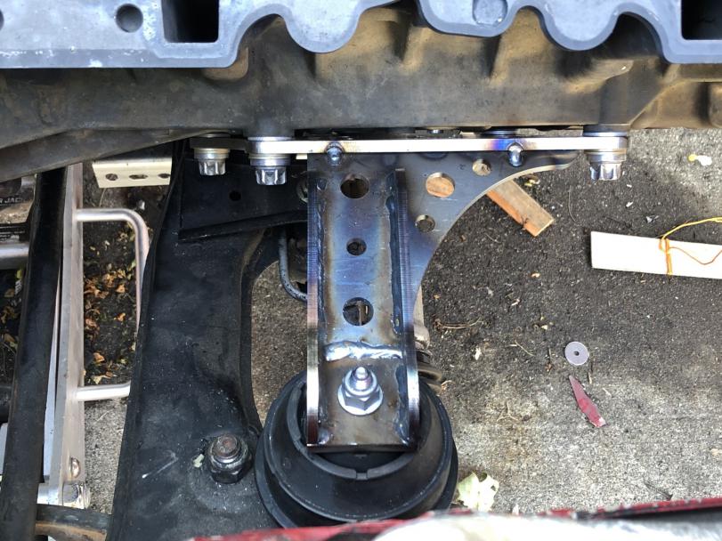

            The arm ends up just aft of the gap between the manifolds.

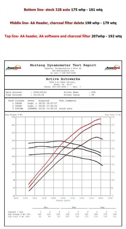

                    ugh please don't tell me this is how much we get out of long tube headers:
                    https://www.europeanboost.com/showth...r-Dyno-Results
                    Please. I don't want it to be this much.
                    Click image for larger version  Name:	Capture.JPG Views:	0 Size:	47.0 KB ID:	9941265
                    I'd believe 10 hp. This is silly.
                    • nando
                      • 34847
                      #250
                      Yeah, I'm not sure about that either. Also, the 328i auto is pretty damn slow. that's 50whp less than mine, bone stock, lol.
                      I happen to know the 2014 version of the AA tune was pretty weak too. but 207whp with just headers, and no 3 stage, on an auto, on a mustang dyno... seems optimistic.
                      But there were definitely guys putting down over 250whp with headers and a tune (and a manual transmission).

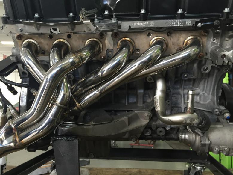

                        This is an early photo of the AA headers. There's certainly plenty hope that they'll clear my engine arms. my motor-mount end of the arm is maybe 1.5-2" higher than the one in the photo here. (that's a guess based on the motor mount height in my car vs the wood blocks I was resting the same arms on.

                        As soon as I build a fixture to stop the engine rotating around the motor mounts (when I remove the not-a-sump) I"ll be able to get a photo from the same angle to the block, here's the best I can do now:

                        From the motor mount back you get into very familiar e30 header clearance problems: the sway bar, control arm bushings, and tunnel. I run the (solid) rubber e30 M3 control arm bushings on my daily in the original castings. switching to lollipop style is necessary for a few header fitments if I recall, and buys you another 3/4" or so. from what I remember of M5x headers, pipes designed for newer chassis hopelessly interfere with the control arm and bushing.
                        The sway-bar can obviously be relocated to the front, but I've got a whopping great big oil pan I'm putting there now.
                        What I see here is plenty of room for me to collect the two manifolds together, but not a lot of hope that pipes designed for a different car are going to clear everything.
