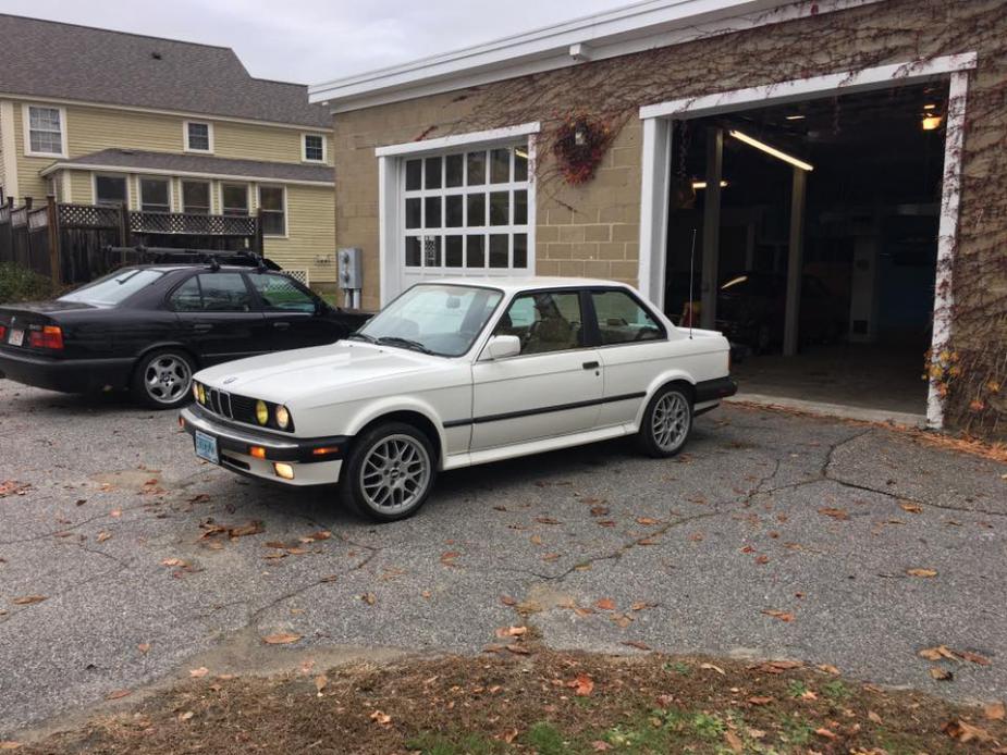

      17" BBS RXs still unsure of what to do on the height

                              BBS RX looks pretty good on the iX! 17" is bigger than i'd go though.
