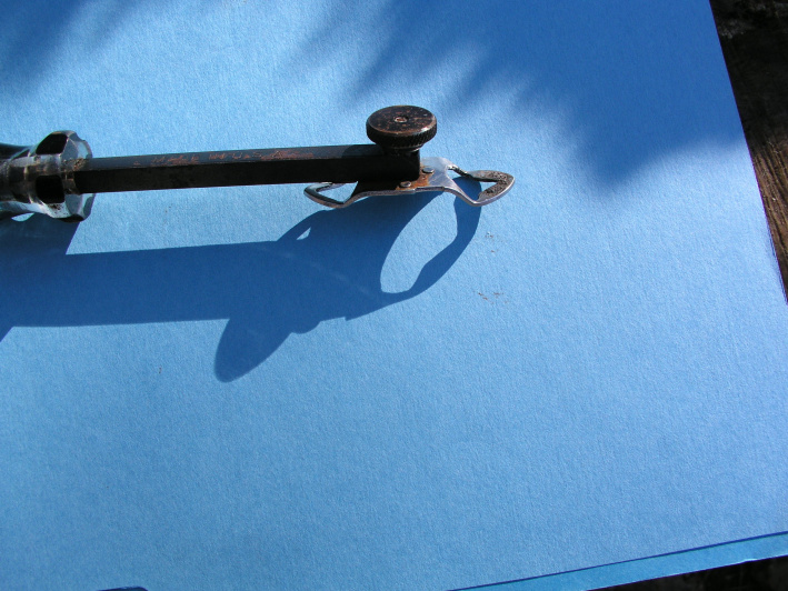

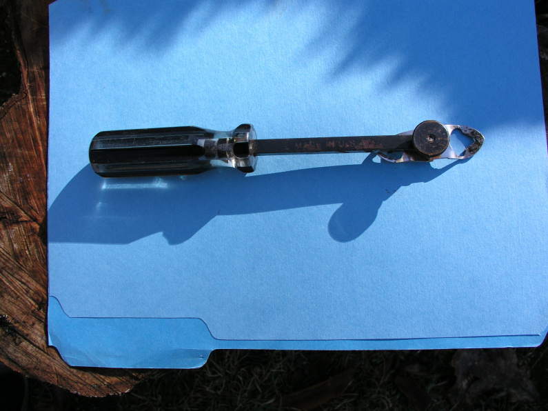

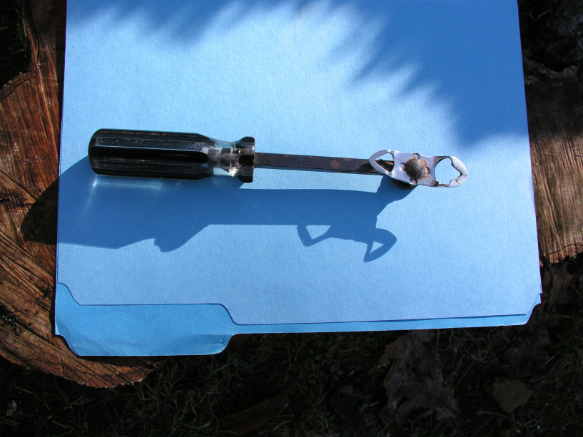

              • packratbimmer
                • Dec 2009
                • 1334
                The tool has a handle and an attachment that glides along the inside of the rubber trim. Within the part that slides, there is a triangular (looks like the shape of a Wankel rotor) shaped opening that one can feed the locking strip/trim through. I'll get a pic later today or so...

                  Okay...well the shape is not exactly like a Wankel.
