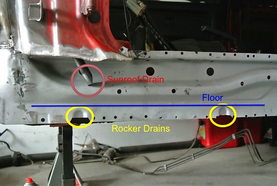

          Originally posted by 82eye
          i was having a look at it and think i might pull the passenger kick panel to see if the drain tubes got cut. always thought they ended just a few ml above the rocker drain.
          edit: i agree with the sunroof grief. i'd much more happily drive a slicktop than have to deal with it.
          I saw it once on a particularly rusty car, found a pic online:
          from: https://bimmerlife.com/2024/10/09/fr...epair-part-ii/
          IG @turbovarg
          '91 318is, M20 turbo
          • 82eye
            • Jan 2009
            • 2109
            thanks varg. you have much much many knowledges.
