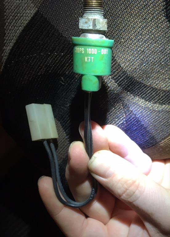

    Hello sir I ran across your amazing article about doing a R134 conversion on a R 12 system for the E 30. I am going to completely go through my system I changed my condenser to a parallel style condenser and I Have disconnected all the hoses so I can completely flush the system and I will replace the evaporator in the car also along with the expansion valve that you recommended for a R134 conversion my car is equipped with the switch pictured below Do I need replace the switch on to the new filter dryer or do I need to get a different switch when converting from r 12 to r 134
