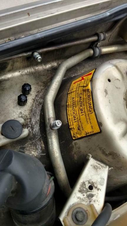

                So I'm running into a snag filling up my car with r134a. I went through and replaced all the O-Rings, dropped the compressor and added oil (in the suction side), replaced the expansion valve and ran a vac on the system for 2 hours or so. When I went to add a can of r134a it took maybe half of the can and just stopped. I sat there for about 25-30 minutes trying to make it take the rest of the can to no avail. I'm putting it in the low side (up against the fender) and the high side is closed. It took enough 134a to run the compressor but nothing more. Is it really slow going? A/C was on full cold with the car at idle. Is there some trick to getting the rest of the can in? Vent temp never dropped to below OAT
                  On my 325e, I believe the connection up against the fender is the high side. The one at the shock tower is the low. Someone else should probably weigh in on that but that might be your problem?
                    Yep. Shock tower fitting be the low side. You're filling from the wrong port. You should see vacuum on the gauge even while filling, at least until you've added about half the can. dont hold the can upside down either, upright and in a warm bowl of water.

                      I'm going to look at it later today but if this is the case what should I do? Vac again and then refil completely or just add the rest to the low side?

                        If you already pulled vac there's no need to do it again. Just add the right amount to the low side and fill by vent temp, not pressure. Fill until vent temp no longer gets colder
