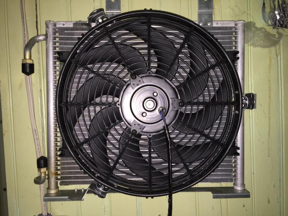

      I got a parallel condensor from rockauto and mounted the fan with conduit straps.

        #363
        This is with a Spal 30102048 16" Pusher.
        Drilled the new rivets off the new condensor and bent/moved mounting points as necessary. Flipped the drivers side mount 180º as it is just screwed on.
